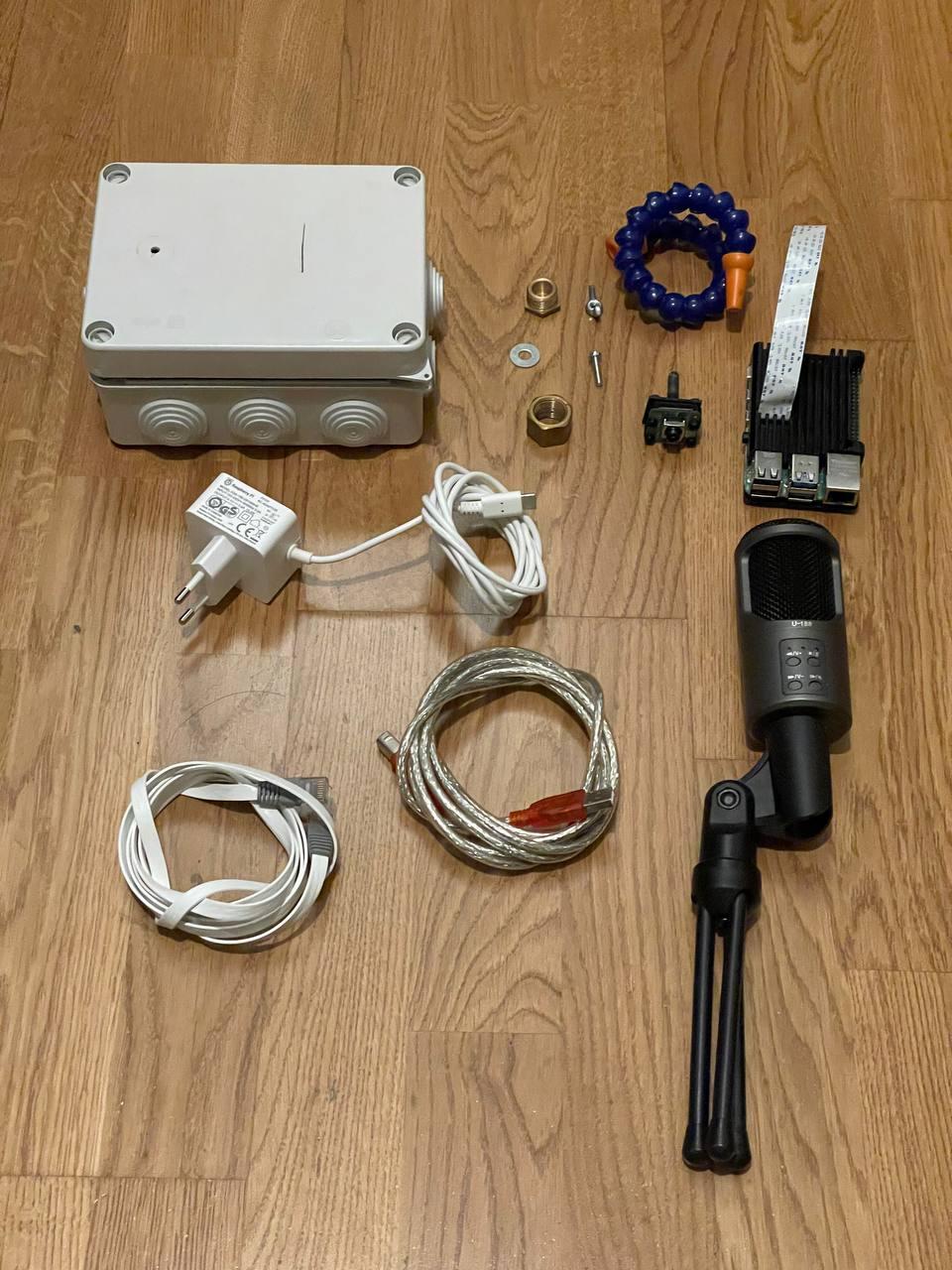

Materials:
- Raspberry pi 4b will work with older models but its recommended for the computing power
- Raspberry power supply
- Something to cool the pi like the case I use is recommended
- Pi camera v3 mine is the wide angle it comes with the cable
- SD card 16 Gb
- An Electrical box mine is 15 cm x 11 cm x 8 cm
- Plastic Flexible Coolant Pipe Hose
- Brass fittings 1/4" cap and female to female
- M4 screw washers and wingnut
- *Optional USB microphone
Tools:
- A computer I use a PC but mac or Linux will work to
- SD reader
- Drill and drill bits
- Screwdrivers
Step 1: Hardware

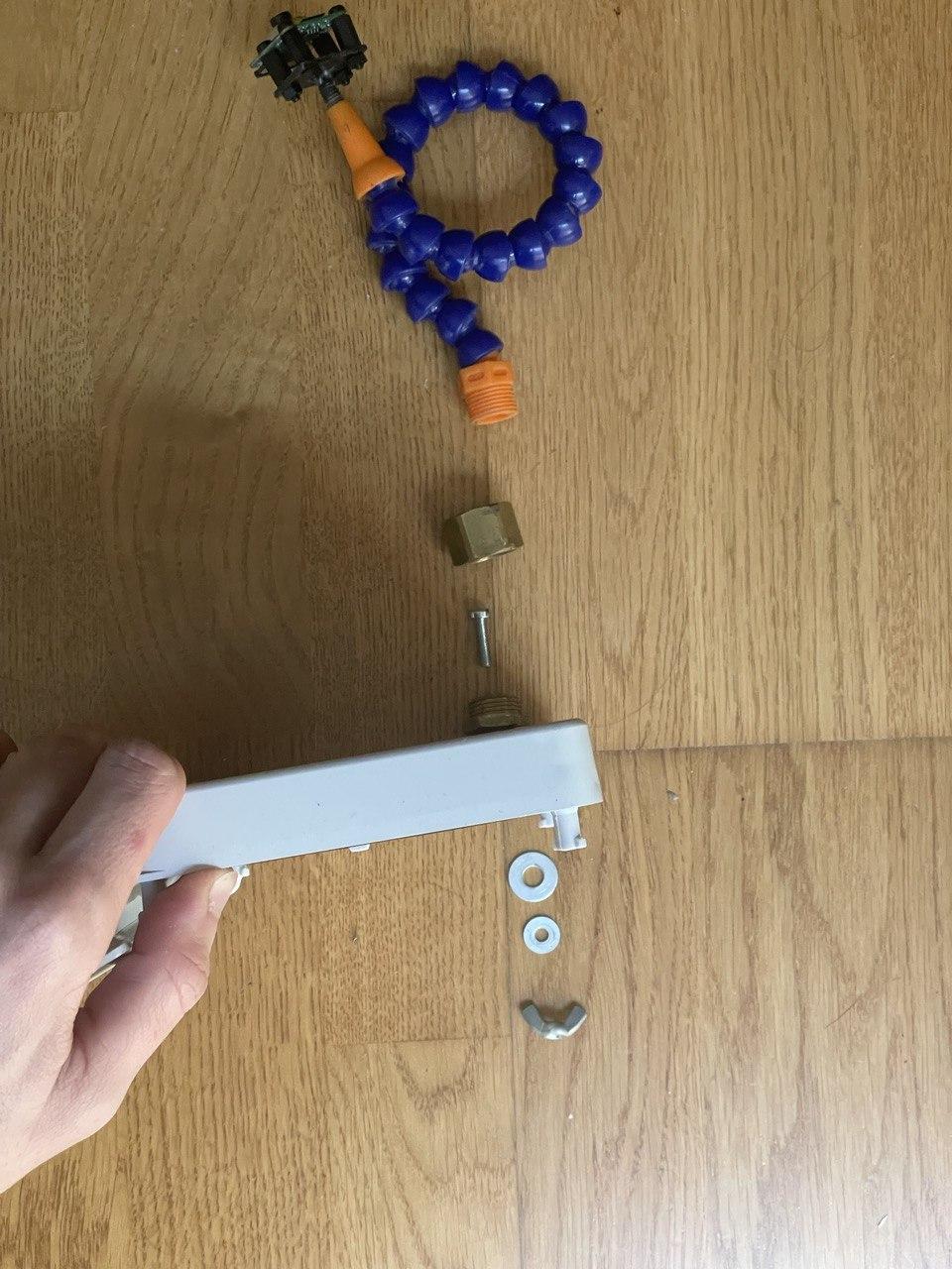

First, we will attach the camera to the box to do this I use a Coolant pipe so I can position the camera freely.

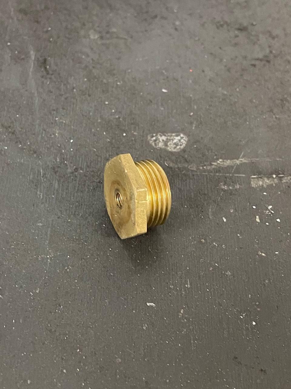

a make a simple adapter out of steel but you can DIY something simple like gluing a camera case to the pipe.

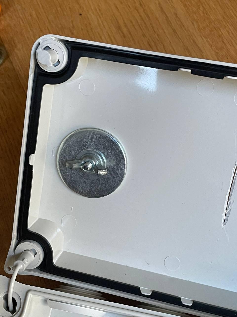

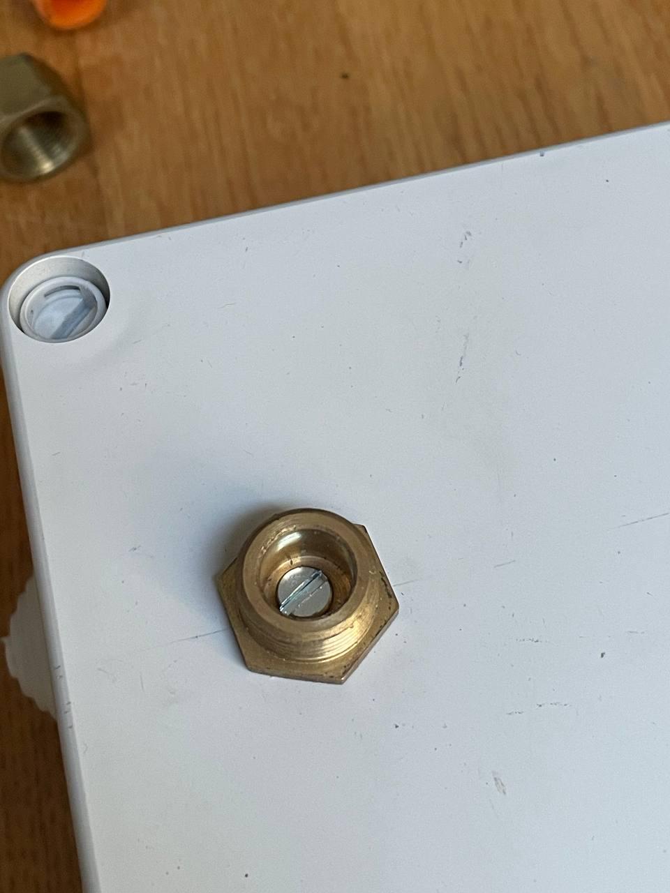

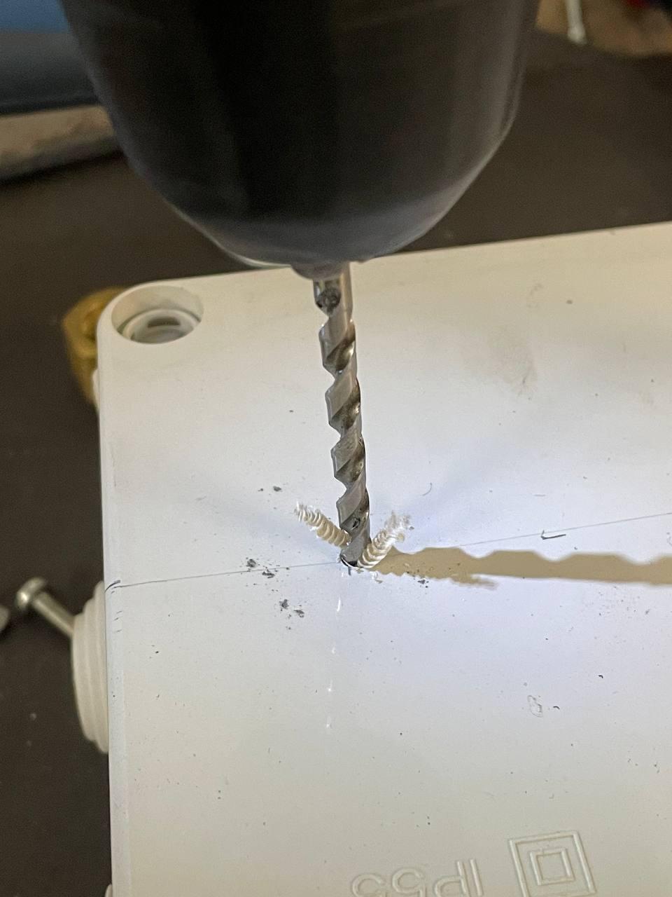

The other end goes to a female-to-female 1/4" fitting and to a brass cap that I drill a hole to pass a screw that gets tightened through the plastic case with some washers and a wingnut.
Now the cable has to go thru the box this is done with a small slip made with a cuter and attaching the cable to both the raspberry and the camera.
Use the rubber grommets to pass the cables.

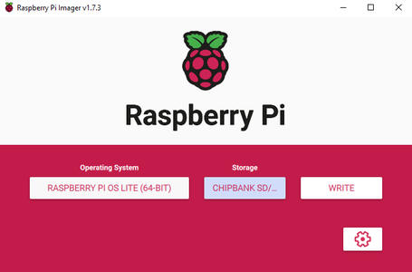

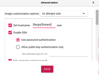

I recommend using the Raspberry Pi Imager you can download it from the official website.
Once its download and installed insert your SD card and select the configuration of the picture
Then on the settings (gear icon) select a hostname, enable ssh, set a password, and set the wifi if you are going to connect it that way cable is preferred.
Once you set everything clicks on write and wait for it to finish and you will have your SD card ready.

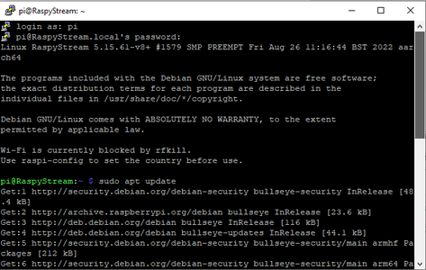

Now its time to connect to the pi I use Putty to connect to the pi but you can use any SSH tool, under host put RaspyStream.local and open, it will ask for the user name and password use the one you write on the Pi imager before the defaults are user pi and password raspberry.

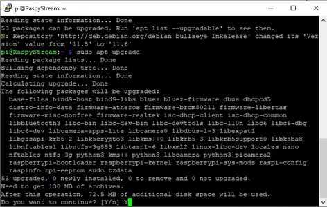

Last let's update everything so we don't have any problems later, write the command:
$ sudo apt update
$ sudo apt upgrade

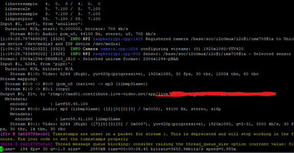

And we are ready to Stream!! just write.
$ ./ScreenIt.sh
After a few seconds, you will see the console telling you the frame rate and other information, go to your twitch channel and see you're self LIVEEEEEE!!!!!!

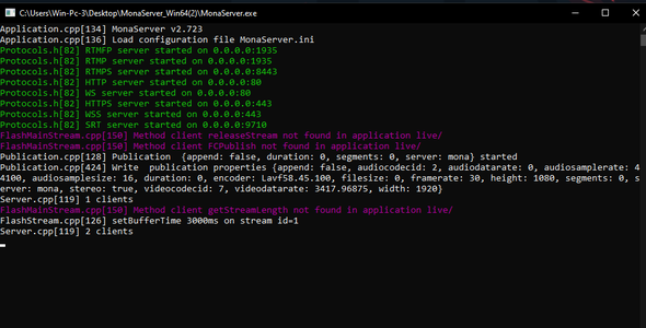

This is a great way to stream online but sometimes you want to test the stream locally or set it up privately, for this we can use MonaServer, which is a small rtmp server, this way we can stream from the Raspberry to a computer and from this computer or other access the stream. To do this we have to follow these steps:
- Prepare Monaserver:
- Download Monaserver2 Windows 64-bit (there are other versions for Mac or Linux here).
- Extract the "MonaServer_Win64.zip" on your desktop.
- Open the folder "MonaServer_Win64" We extract.

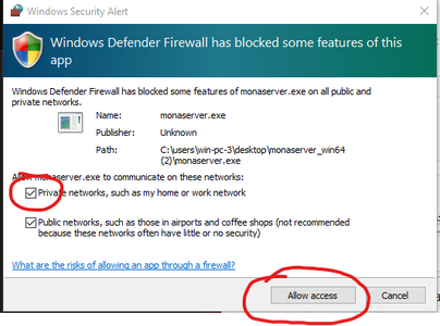

- Right-click on MonaServer.exe and execute as administrator.
- Allow access if Windows prompts a pop-up.
- Change the server on the Raspberry script
- Open the script RaspyStreamLocal.sh and on Ip write: "Ip=10.11.1.201" Remember to write the computer's IP address where you set up the MonaServer.
- Run the script:
$ ./RaspyStreamLocal.sh

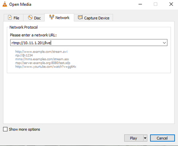

- Connect the client to the server
- Download and install VLC on the computer you want to see the video feed, it can be the same as the Monaserver or other computers and phones with the VLC app in the same network.
- Once it's installed, opened it and go to Media>Open network stream.
- Write the server address on the network URL "rtmp://10.11.1.201/live" (Remember to change the IP address of your computer).
- And last press play.
Now you should see and hear your stream you can also do it on a cell phone with the VLC app the steps will be similar for Mac and Linux computers
