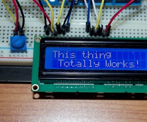

The Rate-Based Arrhythmia Detector was initially designed as a bracelet. However, it was later recognized that its hardware was not compact enough to fit in this form. RAD is currently attached to a 16.75x9.5cm. styrofoam board, making it still portable, lightweight, and convenient when compared to other forms of arrhythmia detection. Alternatives were explored as well. RAD was proposed to recognize abnormalities in the electrical PQRST complex, but cost and size restraints did not allow for the device to possess electrocardiogram (EKG) capabilities.
RAD is user-oriented. It simply requires a user to rest his or her finger on its pulse sensor and allow it approximately ten seconds to stabilize. If a patient’s pulse falls into a range associated with erratic heart behaviors such as bradycardia or tachycardia, the LCD will notify the patient. RAD can recognize seven major cardiac pace abnormalities. RAD was not tested on patients with previously diagnosed arrhythmias, but the device did detect “arrhythmias” simulated by putting the engineers under physical strain prior to testing the device and by mimicking a pulse for the infrared sensor to detect. While RAD possesses primitive input hardware compared to other arrhythmia diagnostic devices, it serves as an economical, user-oriented monitoring device that can be especially helpful to patients with genetic or lifestyle predispositions to arrhythmia development.

1. The first pin of the LCD (VSS) was connected to the ground (GND)
2. The second pin of the LCD (VCC) was connected to the 5V power input of the Arduino
3. The third pin of the LCD (V0) was connected to the second input of the 10K Potentiometer
4. Either of the pins of Potentiometer was connected to the ground (GND) and the 5V power input
5. The fourth pin of the LCD (RS) was connected to pin twelve of the Arduino
6. The fifth pin of the LCD (RW) was connected to the ground (GND)
7. The sixth pin of the LCD (E) was connected to pin eleven of the Arduino
8. The eleventh pin of the LCD (D4) was connected to pin five of the Arduino
9. The twelfth pin of the Arduino (D5) was connected to pin four of the Arduino
10. The thirteenth pin of the LCD (D6) was connected to pin three of the Arduino
11. The fourteenth pin of the LCD (D7) was connected to pin two of the Arduino
12. The fifteenth pin of the LCD (A) was connected to the 5V power input
13. Lastly, the sixteenth pin of the LCD (K) was connected to the ground (GND).
14. The S wire of the Pulse Sensor was connected to the A0 pin of the Arduino,
15. The second wire was connected to the 5V power input, and the third pin was connected to the ground (GND).
The scheme is posted for better understanding the connections.
Step 5: IDE and the Codes
The codes were implemented on the Arduino IDE. C and Java programming languages were used to code the IDE. Initially, LiquidCrystal library was called by the #include method, then fields and parameters of twelve, eleven, five, four, three, two corresponding to the used Arduino pins connected to the LCD were inserted. Variable initializations were performed and the conditions for the BPM measurements and comments were set to the desired outputs to be shown on the LCD. The code was then completed, verified, and uploaded to the Arduino board. The LCD display was calibrated using the Potentiometer to view the comments ready for the trials.
