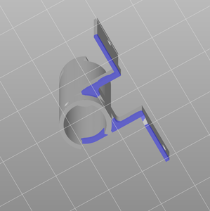

These are the orientations that I print the pieces in. Remember to use supports on the rechargeable battery holder but keep them from inside it. Play around with it in your slicer.
I've printed this on an Ender 3, Prusa Mini, and Artillery Genius. I print with pretty close to the supplied 0.2mm Standard profiles so I'm not going to post my full profiles, but I would enable "print thin walls". You need to cut plenty so I would work under the assumption that this is not reversible unless you keep it together a new way once they're cut.
