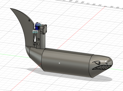

Step 1: Designing the Body
My original design includes 2 3D printed floats joined with a platform made of wood sticks. This platform must be strong, because it supports the floats in order to make them staying in the right position. The desing is inspired by a shark as it can be seen in the image. The stls are also included below if you want to print them. All the parts except the fin are symetrical, so can be used for any of the two floats. The second time you print the fin, it mut be printed mirrored.
For the platform part, I used wood sticks. I smeared them with white wood cola to make them stronger. I also made a small box to keep in safe the arduino, the radio receiver and the battery. If you have some kind of tiny plastic recipe, you can use it too, but make sure that electronics are protected from water in case of spilling.

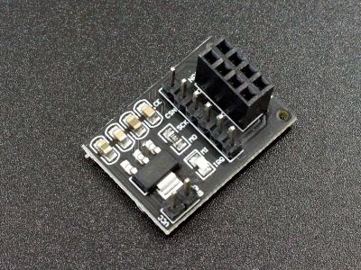

For the wiring of the electronics, I recommend you to use a drilled board. Nrf24 works through SPI protocol, so you have to connect the wiring with the arduino in that way. ESC and servos can be connected into any available pin, for example, 2,3,4,5. Nrf24 works with 3.3V and the 3.3V arduino pin doesn't provide enough current, so I recommend you to buy its voltage regulor board to conect it simply to the 5V and having the enough power.
