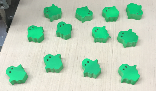

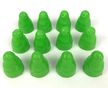

Step 3: Parts 1: Mini Ghosts
In the original game the mini ghosts were made out of plastic (in fact almost the entire game was out of plastic) and I considered having them 3D printed (and may eventually) but I decided to make out of MDF and other materials I had available. So I created a simple tiny ghost design that I could easily cut on my scroll saw. The two eyes I used a tiny drill bit smaller than an 1/8". After cutting them all out (12 total) I based coated with White spray paint. MDF board is like a sponge so it took two coats. After this I gave it a coat of Neon Green, then two hits of Glow in the Dark Paint.
These mini ghosts are collected through out game play. Oh in all of these steps I've put a picture of what the original game part or parts looked like.

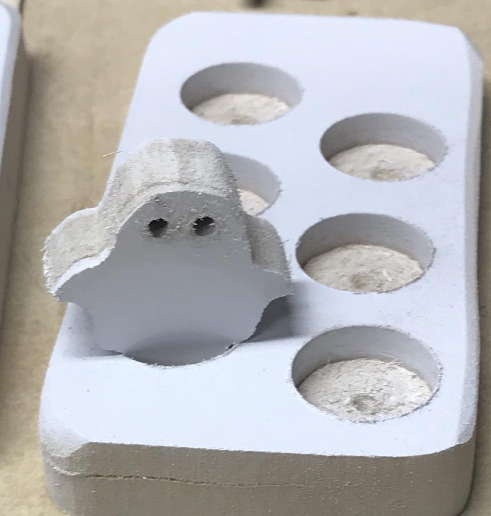

Step 6: Parts 4: Vault Boxes
The Crypt, or as I call them Vault boxes, in the original game were just paperboard boxes that sit under the large openings on the game board. These areas are where the mini ghost hide during the game along with other creepy elements explained later in Step 13.
Lucky for me I work at a carton company and was able to have our cad engineer create me three perfect sized boxes to serve as the vault holes that go under the game board.
Simple design cut and folded that then fit perfect into the holes on my game board.

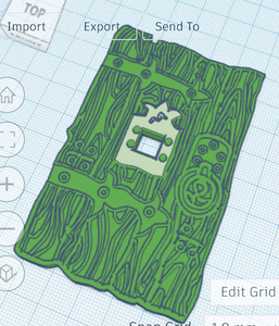

Step 7: Parts 5a: Vault Door Shipwreck
The vault doors were unique challenge in that they were originally (again) made of plastic with another raised plastic piece for the key holes. Each one of these had to have a unique key hole for a specific key to fit with it. I recreated the art work from the original game doors. Since each door is unique I decided to give each door a more unique appearance.
Each lock has a unique geometric shape that a corresponding shaped key works it. I took the art work and using my Cricut Maker cut out craft board in the door shapes. I decide to make the surface of each door themed to its position near the artwork on the board.
This first one is the shipwreck door. I recreated the artwork to the look of the original in Adobe Illustrator. I initially was going to 3D print these as well but due to Covid my access to 3D printer was limited. So applying my old world skills I designed and ran the SVG pattern thru my Cricut Maker using the Deboss tool burnishing the design on Kraft board. The keyhole locks I did separate to give it a raised look.
Once it was cut down I spray painted it Neon Green for the door and white for the Lock. The keyhole for the swamp door is a circle. I went back over the details on the lock with a Silver Sharpie. I mounted a small sheet of plywood to the back of the door with a large enough hole for the key to be inserted and not obstruct its operation.
In the next to last two pics you can see I toyed with the idea of adding lights to the inside of the vaults to where when the doors were close you'd see the keyhole illuminated. Eventually I nixed this idea as the light would be obscured by the mini ghosts and other vault artifacts.

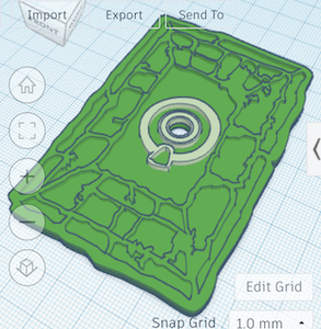

Step 8: Parts 5b: Vault Door Haunted House
The Haunted House Vault Door I had some scrap gold foil sheets that I ran my SVG file design again through my Cricut Maker and mounted it onto the Kraft board. I wrapped the foil around the edges before mounting the plywood portion. If I didn't mention it on the previous door the plywood actually serves as nesting feature to fit the door perfectly into the vault holes.
The keyhole is a triangle for this door and was painted white as well with Silver Sharpie details.
Again the last couple of pics show the show my nixed illumination idea.

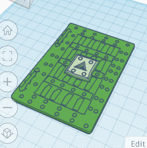

Step 9: Step 5c: Vault Door Hanging Tree
The Hanging Tree Vault Door is made to simulate wood. So lots of wood grain in the original design. Again debossed into Kraft board. I took a ultra fine brown sharpie to bring out the details of the wood. I took the silver sharpie and went over the hardware hinges and door handle. Adding more detail with a black sharpie.
The Keyhole on this door is a square. Again cut out of a separate piece of Kraft board, debossed, painted white and detailed with Silver sharpie.
Last few pics the lighting scheme I decided not to do.

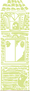

Step 14: New Dice Tower Feature
Since I was doing a die throw to determine the winner I thought it a good idea to take out some of the problems of throwing dice in the dark by creating a contained dice tower. This proved to be a challenge in that I’ve never seen or used a dice tower before (even with all my years of game playing). So more research. After finding some good reference I took and hunk of wood 4" x 4" square about 7-8" tall and using the band saw I cut down into 5 parts.
I first rounded the top portion to give the over all look like that of a Victorian haunted house tower. Once I had the shape I was happy with I lopped off the top portion and drilled a 1” hole through it for the die to fall through. I rounded the edge with hand trim router as well. Taking the bottom portion I cut the sides down by 1/2”. Then cut the inside ramps, simple cuts to cause the die to bounce around on its way down. I glued them all back together but before final assembly I added some green felt for the inner surfaces that the die would bounce off of. For the opening I cut and arched a curve. Check out the SloMo die test video.
Now here is where I went a little CCCRRRAAAAZZZZYYYY. I decided these were big enough surfaces that they needed something. So I did more artwork to make it look like a haunted house tower. I then cut out on the Cricut Maker Glow in the Dark vinyl for each side. FYI these too quite some time on the machine. In fact Cricut software kinda yelled at me saying WOW that's a large file this will take a few minutes LOL.
I then did my two coats prime white and then a couple coats of the Neon Green. After which I transfered all the glow in the dark vinyl to each side. As well as the top.
All in all I thought this was a pretty good replacement solution for the spinner.
