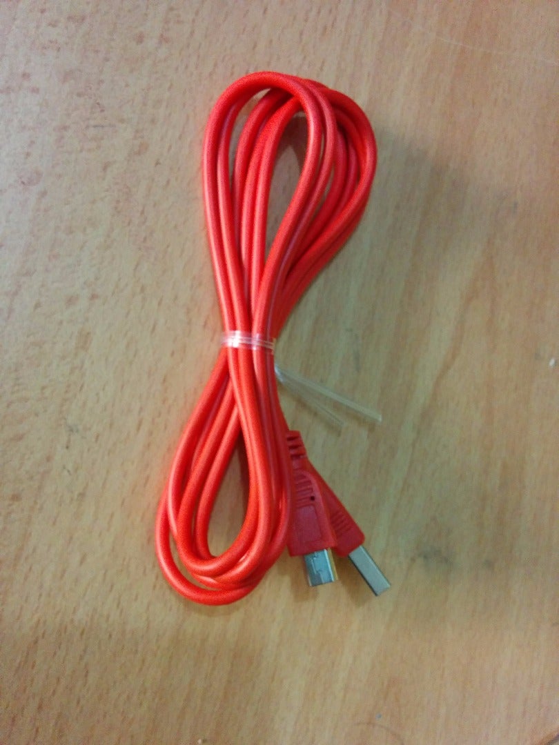

Step 1: Tools and Resources
Here is all the things you need to get started with re-programming the makey makey.

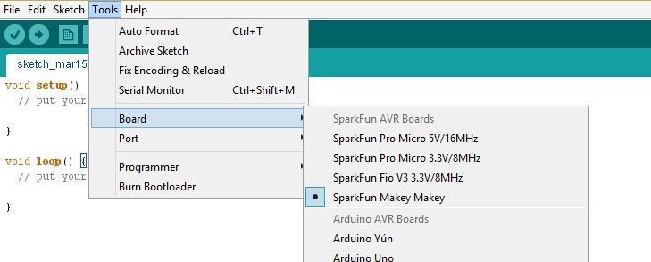

Step 2: Arduino IDE
After you have downloaded the arduino IDE (version greater than 1.5 only) Its time to add the spark fun makey makey plugin to the arduino IDE.

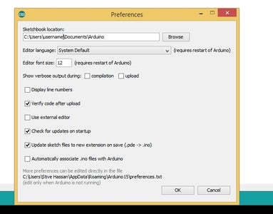

Step 1 - Unzip the zip file to the arduino sketch folder by default it is stored in a arduino folder in My Documents. The path can also be found in the arduino IDE in File > Preferences.
Step 2 - You should have a folder named hardware in the preference location.
Step 3 - Open the arduino IDE and go to Tools > Board you should now have Spark Fun Makey Makey in the list of boards.
Once you have completed the above steps its time to get started with programing.

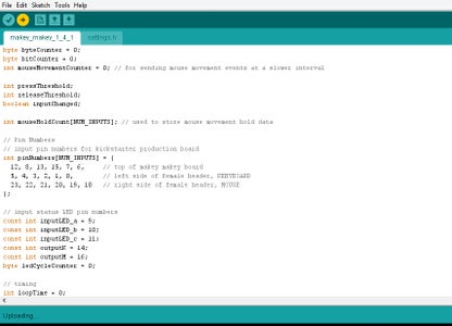

Step 4: Modifying the Code (Re-mapping)
Once you have got the code in the IDE, you should have two tabs one with a .ino extension and one with a .h extension. Generally you’ll only need to futz with settings.h. This is where all of the keys are defined, and there are a few more advanced options to play with the filters, and mouse movement speed.
You can Re-map the keys with other keys of the keyboard the Keys are mapped in the settings.h file and below are other alternative keys you can replace with.

The first variable definition, keyCodes[NUM_INPUTS], is an array of 18 values. Each value in this array represents a single key or mouse input. Each variable in that array has a defined position, called an index, numbered from 0 to 17. KEY_UP_ARROW is at position 0, while, down at the bottom, MOUSE_RIGHT is at position 17
If the Key is an alphabet you can just enter the alphabet followed by apostrophes (only one case is allowed),
For Example a is written as 'a'.
Step 5: Re-mapping 2

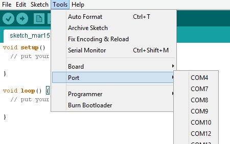

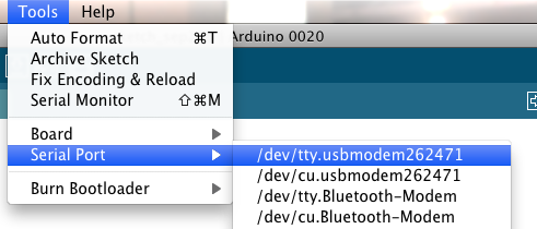

There can be a maximum of 18 Keys in the array in the .h extension file, each key is separated by a comma. The key mapping on the makey makey board can be found in the picture. And once you are done with the mapping you can flash the code to the makey makey, by clicking the upload icon in the arduino IDE. A few of the lights on the makey makey should start flashing and you would get a "Done Uploading" at the bottom of the IDE.
