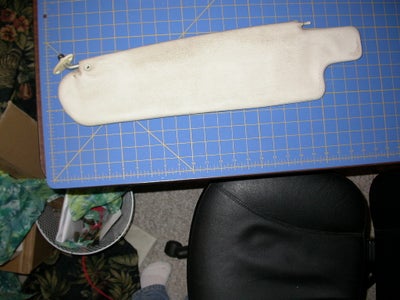

Step 1: Remove Visors From Auto
Remove assembly from auto, being careful to keep all pieces separate from the other sides peices (our driver side visor differs from the passengers side) Now is the time to replace any broken or missing pieces.

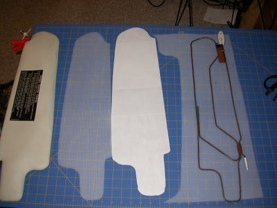

Step 2: Trace Visor
Trace your visor out actual size for reference before removing old cover and padding. I knew I didn't want to use the original covers, so I wasn't careful in removing them. You might want to re use yours, so a few of these steps won't be needed in your project.

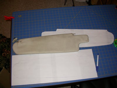

Step 3: Second Visor
Since The visors on our '79 VW bus are different designs, I trace both and labeled each for their sides
Step 4: Cut 2 in Plastic Canvas
I traced out and cut 2 of each pattern in plastic canvas, actual size.

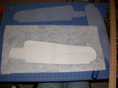

Step 5: Batting
Fold batting, and place top edge of pattern along fold, trace and cut 1 in each shape

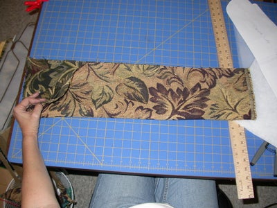

Step 6: Add an Inch
unlike the batting, place pattern bottom along fold and cut out 1 in each shape,But add 1 inch along all edges. With the cover stll inside out, stitch along both ends of the pattern with your sewing machine, leaving the top edge open all the way.

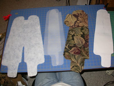

Step 7: These Are the Peices Ready for Assembly
This is what you should have ready to put together.
