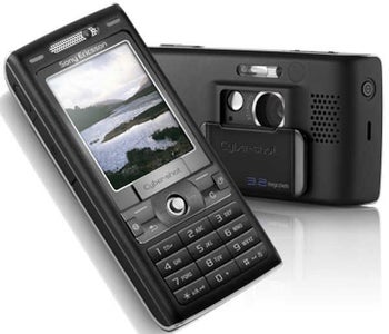

Who doesn't have an old mobile phone? I've got about 5, but the most used is this one I modified to help with my job.
It's a Sony K800i. A rock solid phone, it now mostly functions as an alarm clock, pocket watch and special "What's behind the door?" camera.
If you are wondering about that last bit, rather like a postman, you never want to put your fingers through a letterbox as a locksmith. And I'm a locksmith. Getting bitten by a dog the owner assures you is friendly is just as bad as getting bitten by a dog. So, with this in mind, what do we do?
