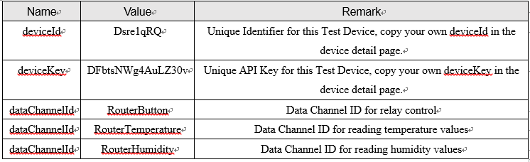

Then in my project I create a new prototype for Linkit Smart 7688 named LinkitRouter, and add three data channels for this prototype they’re Button Temperature and Humidity just as picture below shows.
Now, you’ll get the Device ID, Device Key and 3 Data Channel ID, you can find the information in the test device detail page, and we will need them later.

Change the deviceID, deviceKey and dateChannelID to your device. As shown in the following figure.
