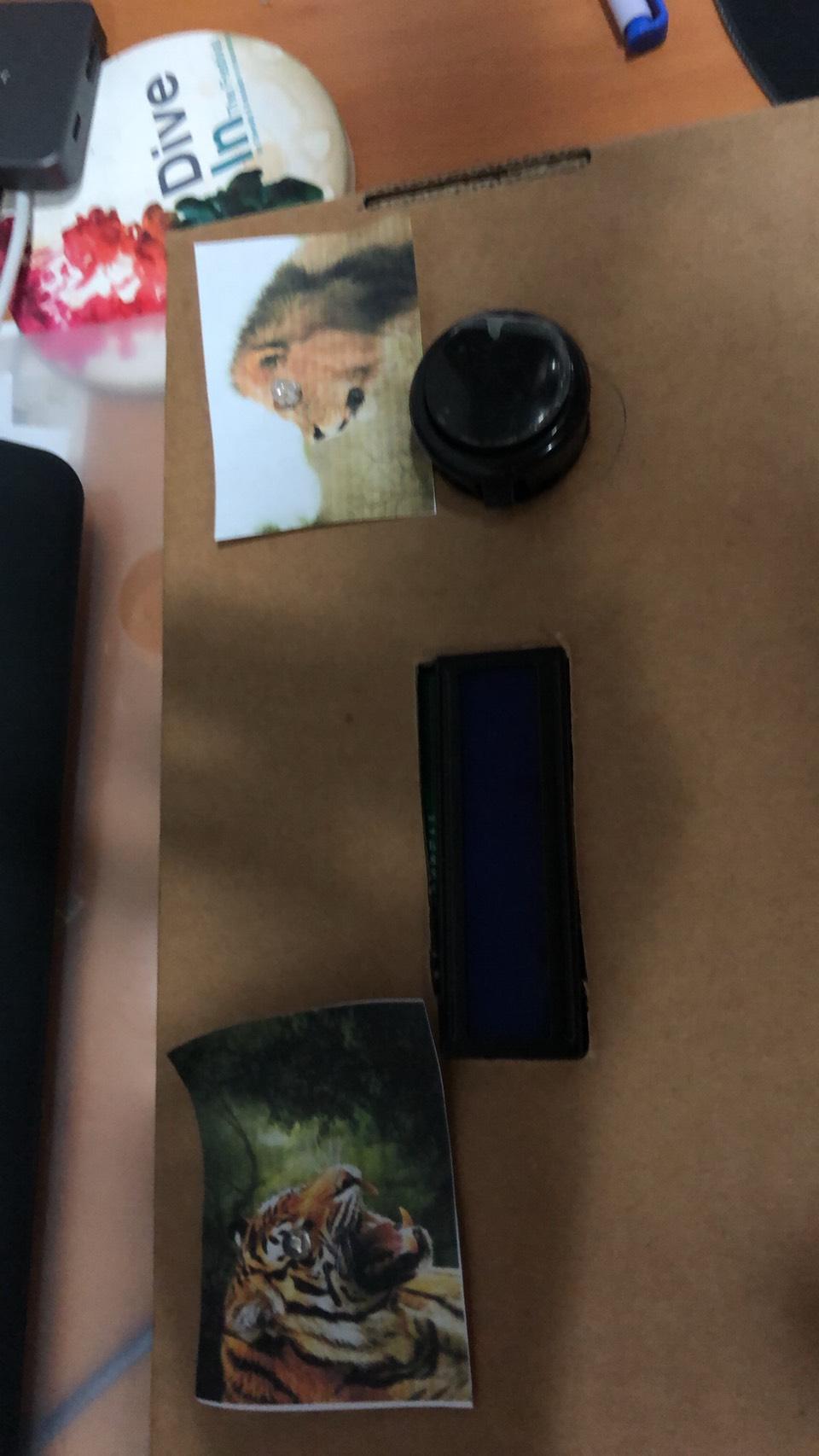

Step 3: Decorate Your Machine
1. Take a cardboard box and cut it to fit your breadboard and device
2. Cut a hole at the box for the ultrasonic sensor to detect (Picture 1)
3. Cut a hole on top of the box to fit the LCD board (Picture 2)
4. Cut a round hole to fit the button on the top of the box (Picture 3)
5. Cut two tiny holes on the top of the box to put the two LED bulbs in it (Picture 4 as one side)
6. Put any two pictures you like on the top and let the LED light be their eyes (Picture 5)
7. Connect the LED lights with crocodile clips (Picture 6,7)
8. Cut a hole at the bottom of the box to let the power cable pass (Picture 8)
