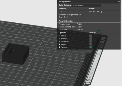

Step 1: Making the Housing
We will start with 3D printing our housing. I used an Bambu Lab X1 Carbon to print and it took around 13 hours and 600 grams of filament. If you want to do something while it prints you can go to step 3. Make sure to enable support to prevent problems! I had to file to bigger the gap where the MPU comes (see step 2) a little bit because it was too small. If you want you can prevent this by changing the STL before you print.
When it's printed we just need to remove our supports from the bottom housing and then step 1 is already completed!

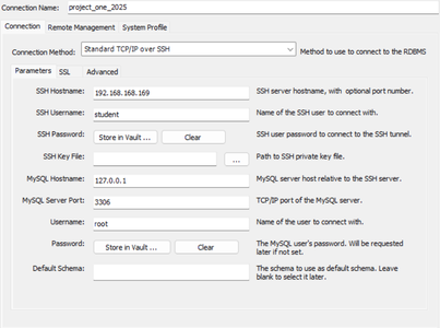

Configure MySQL Workbench to connect over SSH
You will now set up MySQL Workbench on your own computer.
  1. Open MySQL Workbench on your laptop.
  2. Choose a connection name (name doesn't matter)
  3. Click to create a New Connection.
  4. Set the Connection Method to Standard TCP/IP over SSH.
  5. Fill in the following fields:
  6. SSH Hostname: 192.168.168.169
  7. SSH Username: student
  8. SSH Password: P@ssw0rd (or your own password)
  9. MySQL Hostname: 127.0.0.1
  10. MySQL Server Port: 3306
  11. MySQL Username: root
  12. MySQL Password: r00tP@ss
  13. Save the connection if possible.

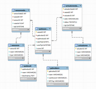

The database
This project is made in Dutch so that includes the database. But I will give here the translations and explain what each table does in the database. If you want you can change the name of the tables but then you will also need to change the python and javascript code. If it's requested/I have some time, I will try to set all the code in English.
  1. gebruikers – Users (This table stores information about the players.)
  2. Each user has a unique ID.
  3. It saves their name, password, and NFC tag.
  4. spelmodi – Game Modes (This table defines different game modes)
  5. Each mode has an ID, a name (like Minuut Challenge), and a description.)
  6. spelsessies – Game Sessions (Each time a user plays a game, a session is stored here.)
  7. Links to a user, game mode, Actuator Data, and Sensor Data.
  8. Records the start time, end time, and the score achieved.
  9. sensoren – Sensors (This table contains all available sensor types.)
  10. Each sensor has a name and a type.
  11. sensorendata – Sensor Data (This logs every sensor reading during a game session.)
  12. Each entry links to a session and a sensor.
  13. Stores the value read and a timestamp.
  14. actuatoren – Actuators (This table defines the hardware that provides output.)
  15. Each sensor has a name and a type.
  16. actuatorendata – Actuator Data (This logs every time an actuator is activated.)
  17. Records the action, whether it was successful, and the timestamp.
  18. Links to the session and actuator.
Relationships
The database uses foreign keys to link data:
  1. A game session is linked to a user and a game mode.
  2. Sensor and actuator data are linked to their respective sessions.
  3. This structure allows you to track exactly what happened during each game in terms of inputs and outputs.

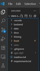

If you have done everything correctly you will see left in VS lots of code files in a folder structure. To help you understand most of it I will explain the two most important folders, and the files in these folders.
Backend
  1. Purpose: Contains all backend (server-side) code for your project, including the main application, hardware integration, configuration, and database logic.
  2. Key files:
  3. app.py: Main entry point for the backend server. Controls and directs all hardware, sends data to database and frontend.
  4. config.py: To make an connection with the database.
  5. main.py: To test all components together without threading, javascript, .. .
  6. arcadeknop.py, joystick.py, knop.py, lcd.py, led.py, mpu.py, rfid.py, ws2812B.py: To test every component alone (buttons, joystick, LEDs, LCD, RFID, etc.).
  7. gamemodes.py: To test how game modes are selected.
  8. repositories/: Contains data access logic (database queries).
  9. models/: Contains data models (classes representing database tables).
  10. klassen/: Contains helper classes to make it easier in app.py and other files
