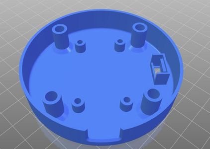

Step 1: 3D Print CPB Mount
First, I had to 3D print a mount for the CPB to lay on. I found a design meant for a lantern for the CPB, but it works for our boxing gloves in this case. Here is the link to the design: https://www.thingiverse.com/thing:2418725/files. There are many resources out there on how to 3D print, so please research online before printing on your respective printers. I used the Prusa Mini.
It took around 2.5 hours to print the mount, and then I superglued it onto my right boxing glove. Super awesome!
Step 2: Assemble Battery and CPB Onto Mount
I then taped the battery pack to the "wrist" part of the gloves as shown above, so the battery would not fall while I was punching. Next, I screwed two screws into the mount as shown above, so the CPB would not fall while I was punching.
The 3D-printed mount had big enough holes for some screws, but you may need to tinker to find the right size of screws.
That should be enough support for the CPB to be powered by the battery pack without falling off the gloves! All you need to do is attach the battery pack to the CPB in order to power it up!
