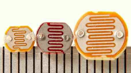

*LDR
A photo resistor or light-dependent resistor(LDR) or photocell is a light-controlled variable resistor. The resistance of a photo resistor decreases with increasing incident light intensity; in other words, it exhibits photo conductivity. A photo resistor can be applied in light-sensitive detector circuits, and light- and dark-activated switching circuits.

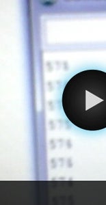

Step 4: Upload
Above pics represents first when light is not falling on ldr(single digit)
secondly light is falling on ldr (two or three digit number)
