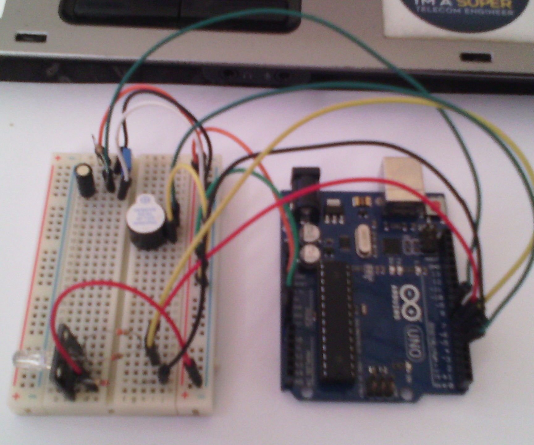

Step 4: The Receiver of the Action(from the Gloves)
Now it's the time to work in the other side.The receiver system is an Infrared receiver that reads the codes transmitted by the gloves and then the Arduino(in the receiver system) sends a command to the relay to change his state (if ON go OFF/if OFF go ON).
I choose to apply my commands on a bulb to switch it ON or OFF.
Because we are using the infrared communication we could apply these gestures to command increase the volume of the TV ,change the channel or turn off too.You have just to know which protocols the remote control uses.i would like to add it but the important is the logic/he principle of this project.
For the circuit is so much easy for you but in case of problem contact i will make it for you ;).
check the code below.
