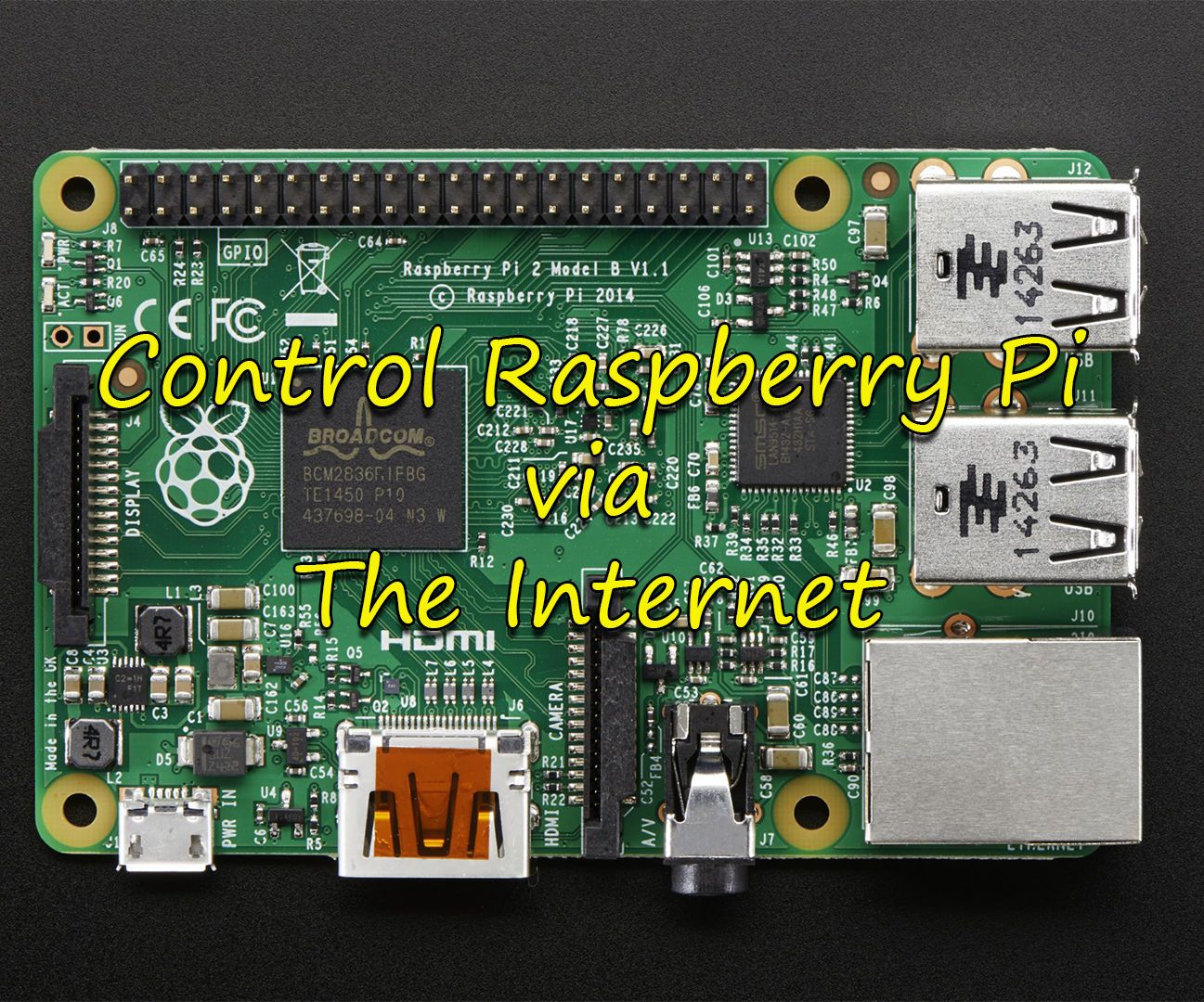

We are using DS18B20 temperature sensor to get the temperature of your room.
