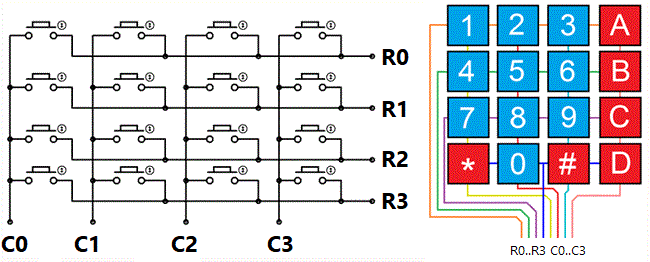

As shown, the 16 keys are just like 16 buttons. However you do not have 16 pins to read states of the 16 buttons. Instead, 4 "row pins" are connected to one legs of the 16 buttons; and 4 "column pins" are connected to the other legs of the 16 buttons.

Step 2: The Connection
  • Connect R0 pin of Keypad to pin 12 or Arduino UNO.
  • Connect R1 pin of Keypad to pin 11 or Arduino UNO.
  • Connect R2 pin of Keypad to pin 10 or Arduino UNO.
  • Connect R3 pin of Keypad to pin 9 or Arduino UNO.
  • Connect C0 pin of Keypad to pin 8 or Arduino UNO.
  • Connect C1 pin of Keypad to pin 7 or Arduino UNO.
  • Connect C2 pin of Keypad to pin 6 or Arduino UNO.
  • Connect C3 pin of Keypad to pin 5 or Arduino UNO.
