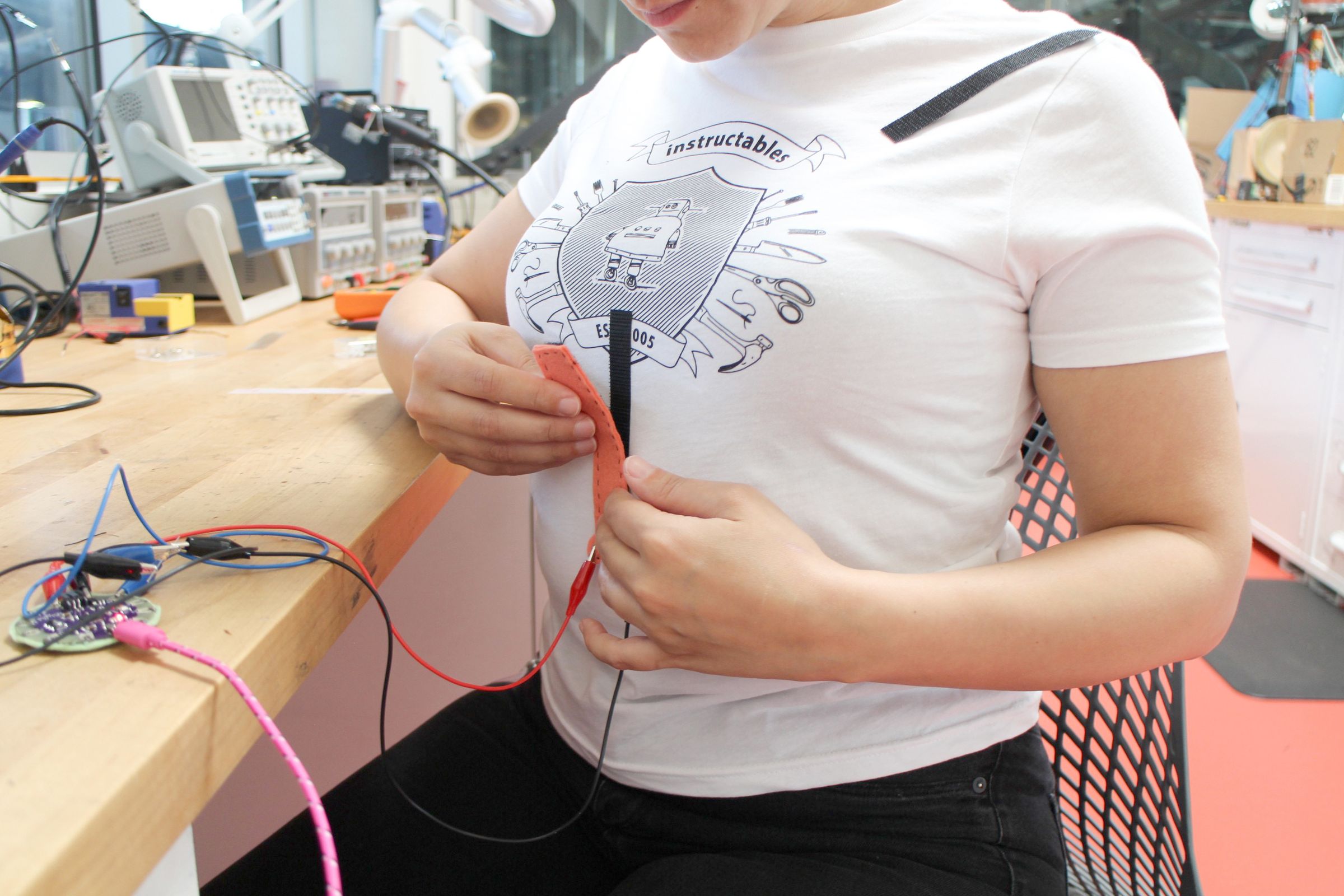

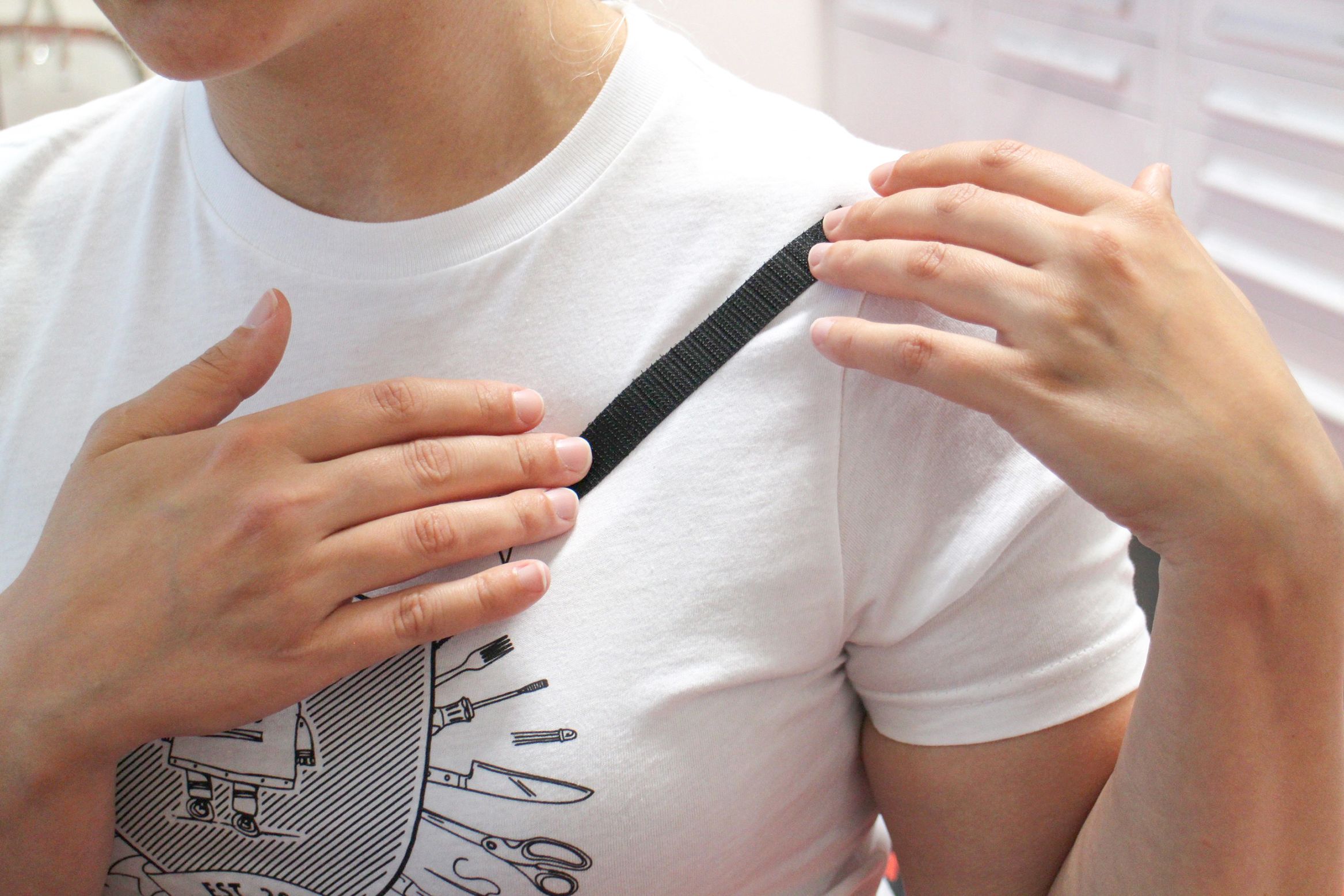

When testing how to best capture a movement with a sensor you need to be able to move it around the body easily. Sticky-back velcro is good for this, it can be repositioned on the garment and allows you to secure the sensor down in multiple places.
There are two sides to velcro, the loop (softer), and hook (harder) side. Cut two pieces of the hook side and one of the loop to match the length of your flex sensor. Peel the backing off both hook pieces and press them onto the t-shirt where you want to test: the shoulder and the torso.
Place the loop side onto the back of the sensor.

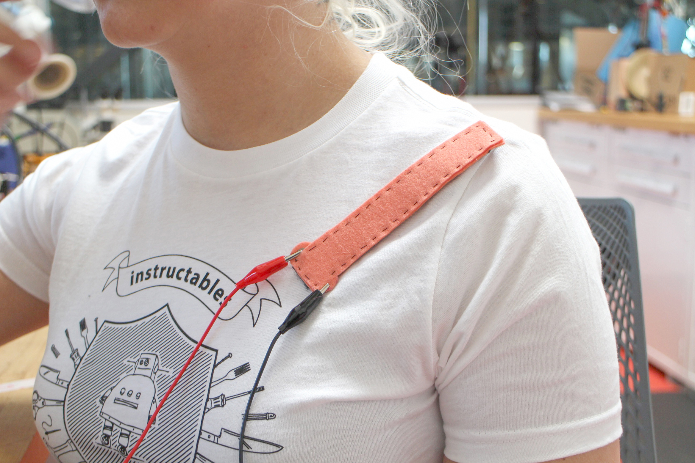

Step 5: Clip to Sensor

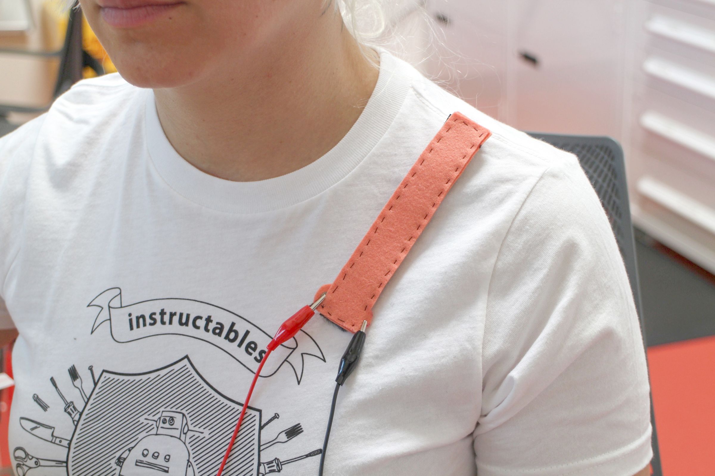

While the sensor is still off the t-shirt, grab two alligator leads and clip them to the sensor.
Step 6: Place the Sensor

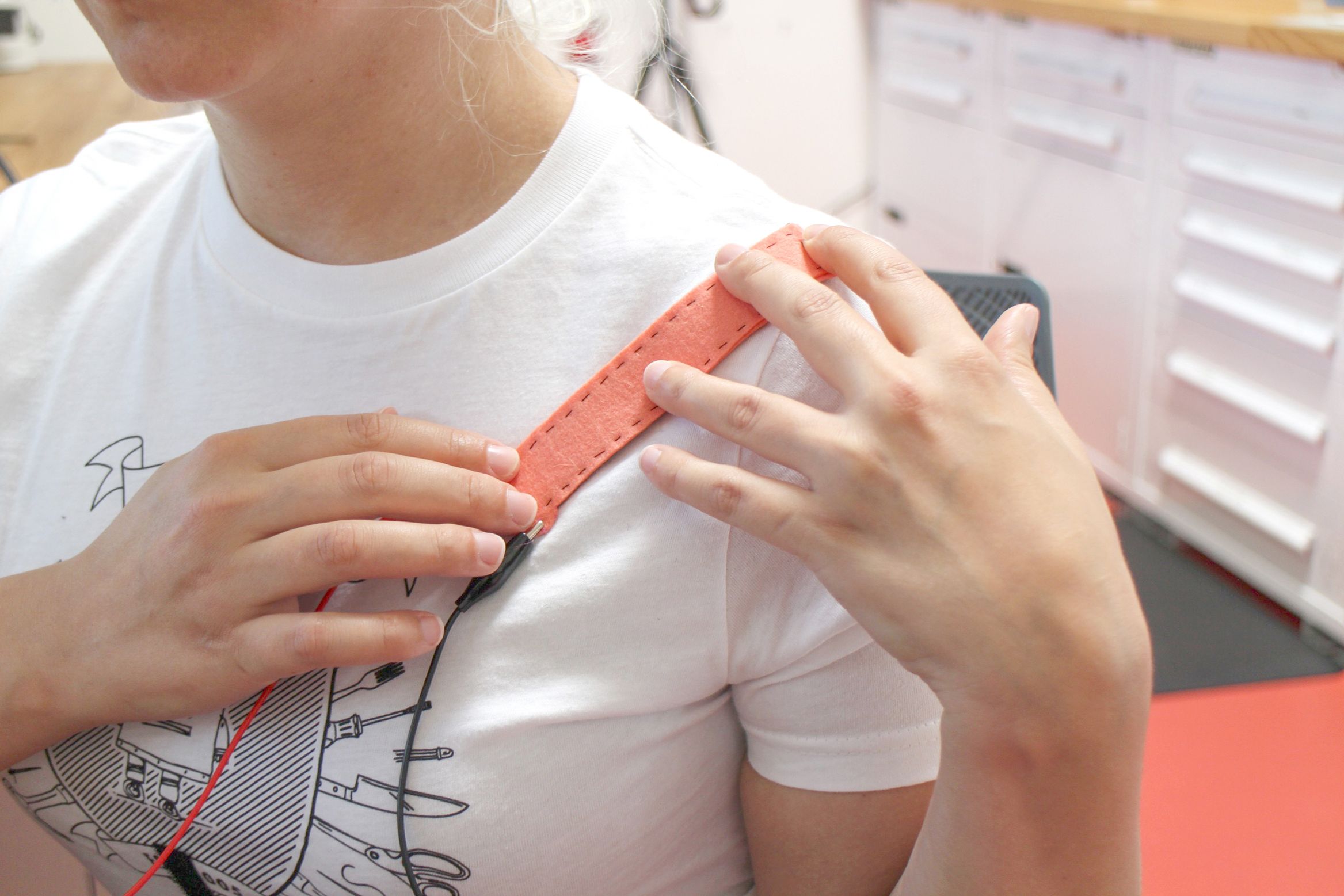

It's time to put the sensor onto the body! Let's start with the shoulder area, press the sensor down onto the velcro and smooth down.

The sensor is placed and now you are ready to read some values in the Arduino software! By looking at how the sensor behaves in Arduino you will be able to determine if it's in a good place to capture the bend in the shoulder area that happens when you slouch. This is the same circuit from the Analog Input lesson minus the LED. Below you can also see that I am connecting to the resistor without using the felt breakout. Either way works.
While it is velcroed to the shoulder, connect the sensor to the LilyPad. Don't forget the resistor!
Connect the circuit as illustrated.
flex sensor --> power (+)
flex sensor --> resistor
resistor (same side the flex is connected to) --> pin A2
resistor --> ground (-)

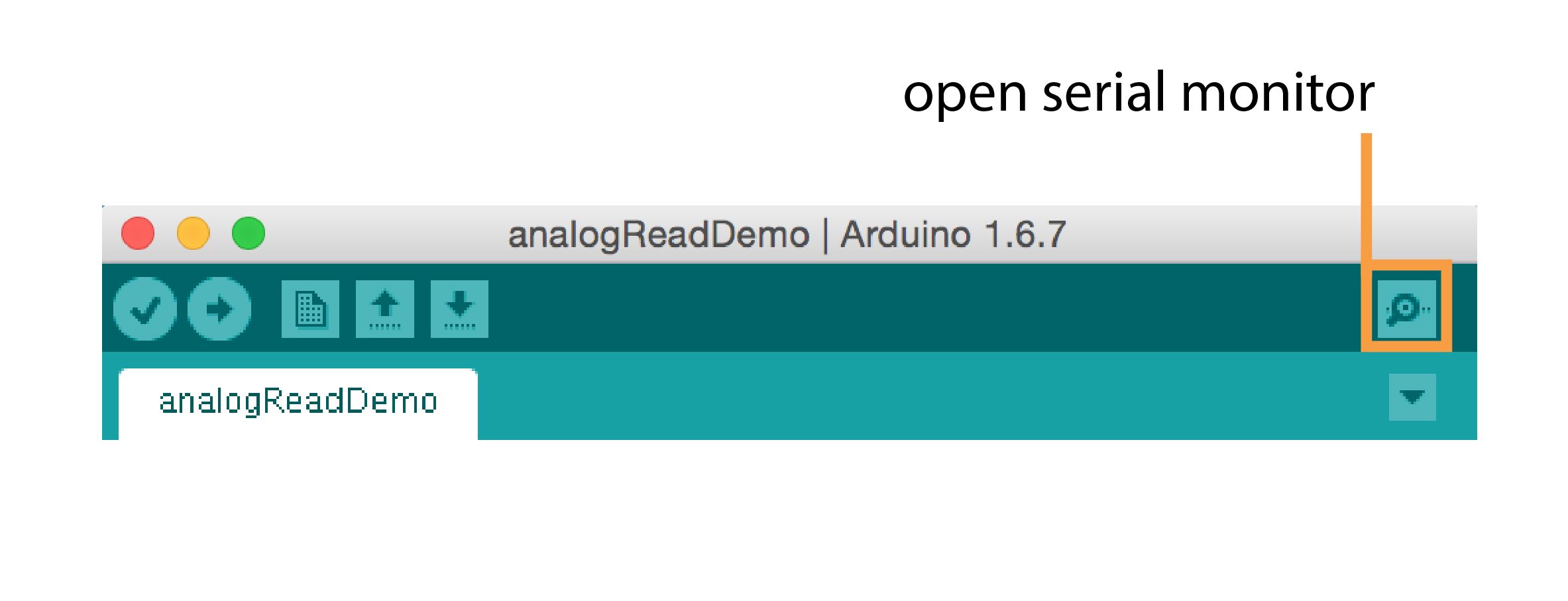

The difference between this sketch and the one you started off with in the Analog Input lesson is that there is no LED. This sketch just reads the sensor's varying voltage and serial prints the values to the serial monitor. If you haven't already, connect the board to your computer via USB and turn the board on. Hit upload.
Turn board on.
Upload sketch and open serial monitor to see sensor values.
Once the sketch is uploaded open the serial monitor.
Look at the stream of values while you are in a straightened position. Now slouch and watch what happens to the sensor values. They will be jumpy but you should see the values go up. Repeat the action: straight, slouched, straight, slouched. What you are looking for is repeating behavior from the values. You also want the difference between the values you get while straight to be far enough away from the values gotten while slouched. For example, If your values are at 700 when straight and around 730 when slouched that 30 value difference is most likely going to be too difficult to read accurately each time. Especially when the sensor's values jump quite a bit. Even when you smooth the values, which you will do eventually, you need the difference to be as large as possible.

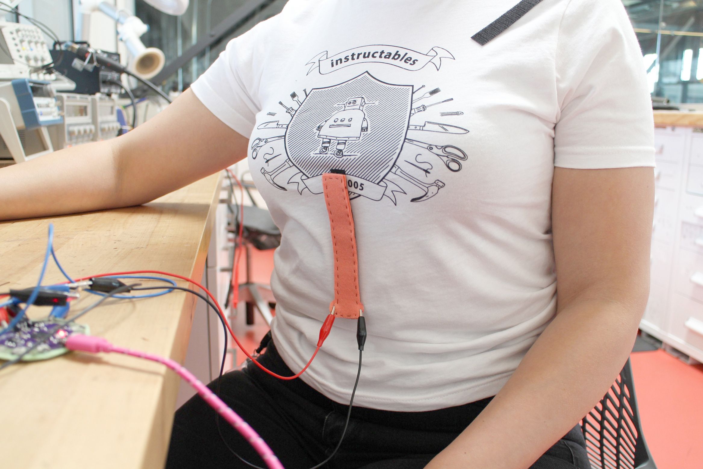

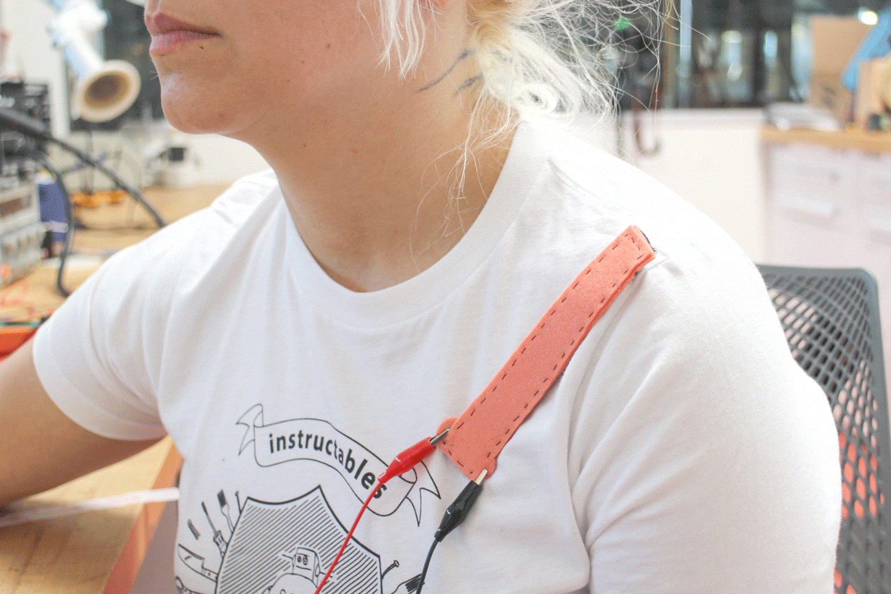

If you feel like the values you get while straightened and slouched are too close together try repositioning the sensor on your shoulder. Do this by removing and sticking the velcro and sensor sandwich to another position. For example, I found that if I angled the top of the sensor more towards the point of my shoulder I got a larger difference. As you experiment and move the sensor around record the straight and slouch values for each position. In the least, record the straight and slouch values for the position you like best on the shoulder.
Old position.
New position.

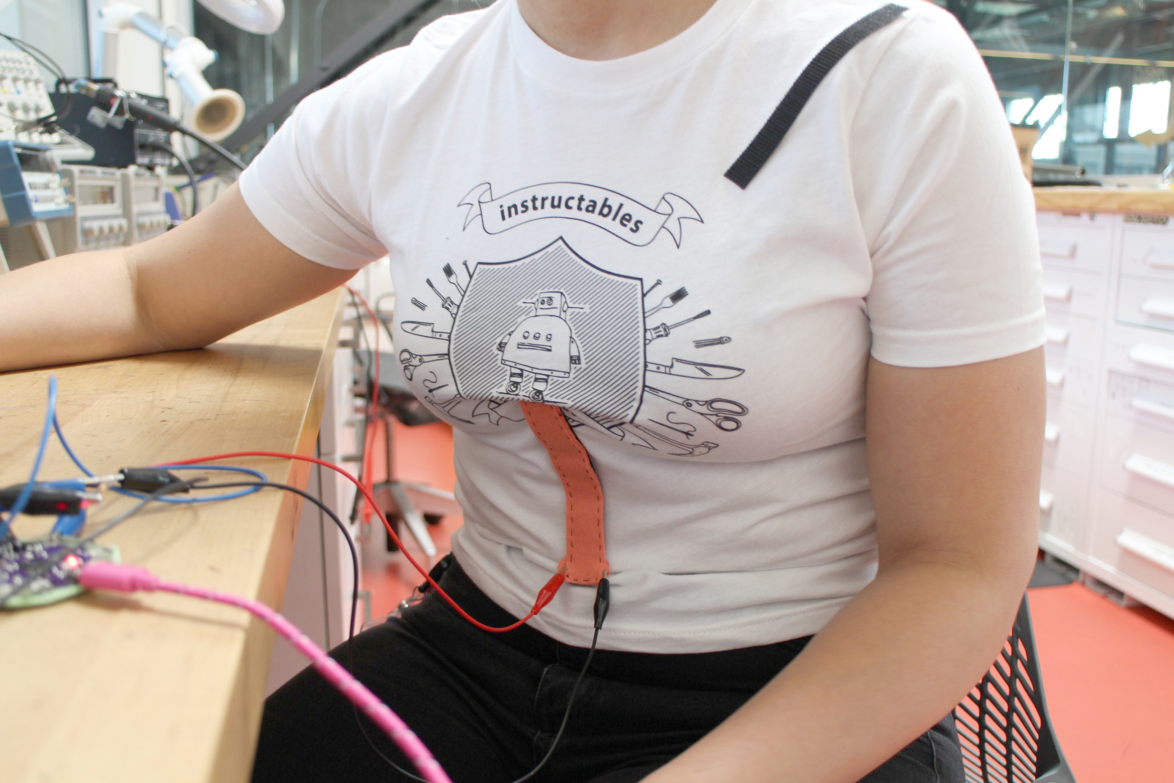

After you have experimented with the shoulder, try the sensor at the second position on the torso and see what kind of readings you get there. Remember, you want the values to be able to hit a general range of values repeatedly. You will smooth the sensor values later so that will help with any jumpiness. Record the straight and slouch value from the torso reading. You should now at least have two sets of values.

Take a look at your sensor readings and choose a place that you feel will allow you to capture a slouch. Another thing to remember is comfort. Although I saw a bigger difference between straight and slouch on the torso, I partially decided to go with the shoulder for comfort. The other factor was visibility, it's easier to illustrate the final circuit when the sensor is on the shoulder.
Pick one spot that you got some good readings from. Once you have decided, you are done with the testing and placement of your sensor! Take it off of the shirt carefully leaving the hook side on the t-shirt so you know where it goes once your transfer the circuit onto the t-shirt.
