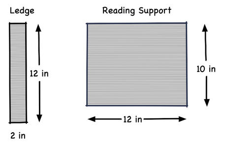

Step 1: Measure and Cut Parts for Front Piece
The direction of the cardboard's grain does not matter for these cuts

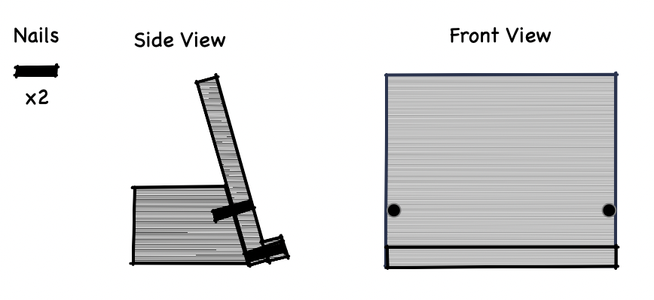

Step 2: Assemble Front Piece
1. Punch holes for nails
2. Join pieces with white glue
3. Put glue in nail holes
4. Put nails in holes

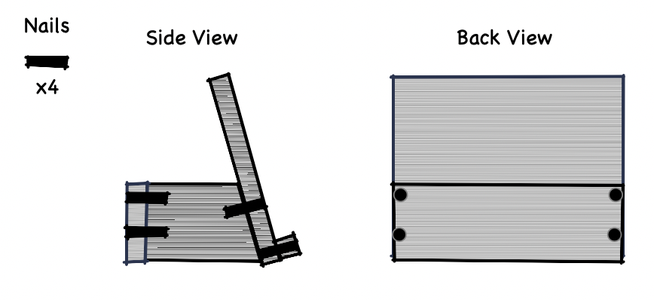

Step 4: Measure and Cut Back Piece
The direction of the cardboard grain doesn't matter for this cut
Step 5: Attach Side Pieces
2. Join side pieces to front piece with white glue
Step 6: Attach Back Piece
2. Join back piece to side pieces with white glue

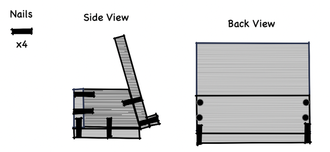

Step 7: Measure and Cut Bottom Piece
Step 8: Attach Bottom Piece
2. Join bottom piece to side pieces with white glue
