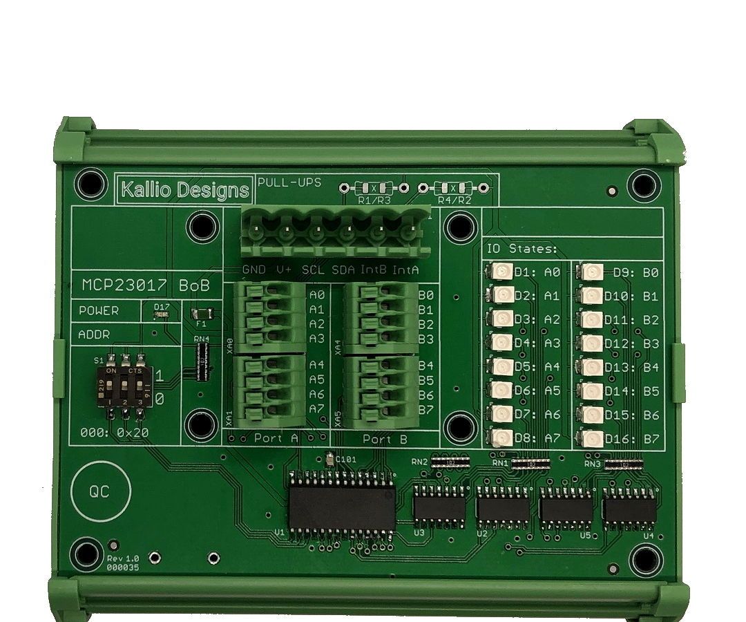

- Connect the Sensor Bridge power supply to the screw connector in the front
- If you are using an adapter PCB, connect the wires according to silkscreen on the adapter board
- If not using an adapter, refer to the pinout for connections
- You can also power the device with Power over Ethernet (PoE)
- Connect an ethernet cable from the front port to your router, you should see the green indicator LED lit as well as the ethernet port LEDs indicating traffic.

If you are using the adapter, just connect the wire connector.
If not, refer to pinout image and T9602 datasheet:
Sensor Bridge pins (wire color):
- GND (Power supply negative)
- Voltage Input (Power supply positive)
- SCL (Black wire)
- SDA (White wire)
- GND (Green wire)
- Sensor power 5 V (Red wire)

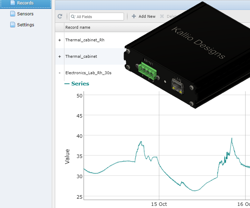

Step 3: Read Results
Open your chosen browser (Tested on Mozilla Firefox, MS Edge, Google Chrome).
Enter http://192.168.1.190/T96025D1RH in the address bar, and you should see a humidity reading. Use http://192.168.1.190/T96025D1T to read temperature.
You should see the reading displayed.
You can also use Python or other programming languages capable of HTTP communication. Sensor Bridge sends out the required metadata for browsers and software libraries.
