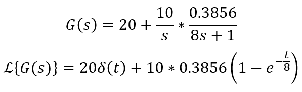

So I mentioned that the PT100 has a slow response but we can get a formula for the current temperature read by the PT100 at any time t. The response of the PT100 is a first order response which in can be written in Laplace terms i.e. transfer function, as:
where tau(τ) is the time constant, K is the gain of the system and s is the Laplace operator which can be written as jω where ω is frequency.
The time constant tells you how long it takes a first order system to settle at its new value and a rule or thumb is that 5*tau is how long it'll take to settle at the new steady state. The gain K tells you how much the input will be amplified. With the PT100, the gain is how much the resistance changes divided by the temperature change, from picking two random values from this datasheet, I got a gain of 0.3856 ohm/C.
Before I said you could record the voltage every 2s after you put the probe in the liquid, hot or cold, from this we can calculate the time constant of the system. First you need to identify where the start point and end point, the start point being the voltage before you put the probe in the liquid and the end point being when it settled. Next subtract them and that's the voltage change of the step, the test you conducted was a step change which is a sudden change in input to a system, the step being temperature. Now on your graph go to 63.2% of the voltage change and this time is the time constant.

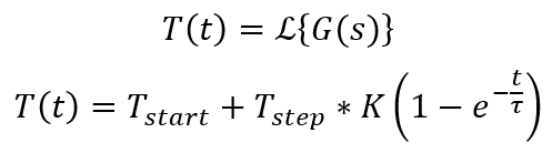

If you plug that value into the transfer function, you then have the formula to describes the frequency response of the systems but that's not what we want right now, we want the actual temperature at time t for a step in temperature so we're going to have to perform an inverse Laplace transform of a step into the system. The transfer function of a first-order system with an input of a step is as follows:
Where Ks is the step size i.e. the temperature difference. So let's say the probe is settled at 20 degrees C, placed into water at 30 degrees C and the probe has a time constant of 8s, the transfer function and time domain formula is as follows:
The δ(t) just means an impulse i.e. DC offset of 20 degrees C in this case, you can just write 20 in your equations when calculating this. This is the standard equation for the step into a first order system:
The above calculates the temperature at time t but this will work for the voltage as they are proportional to each other, you just need the starting and ending value, time constant and step size. A website called Symbolab is great for checking if your maths is right, it can do Laplace, integration, differentiation and lots of other things and it gives you all the steps along the way. The inverse Laplace transform the above can be found here.
