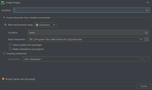

S1. Let’s start our project: if you are on the Welcome screen, click Create New Project. If you have already got a project open, choose File -> New Project.
S2. Select Pure Python -> Location (Specify the directory) -> Project Interpreter: New Virtualenv Environment -> Virtualenv tool -> Create.
