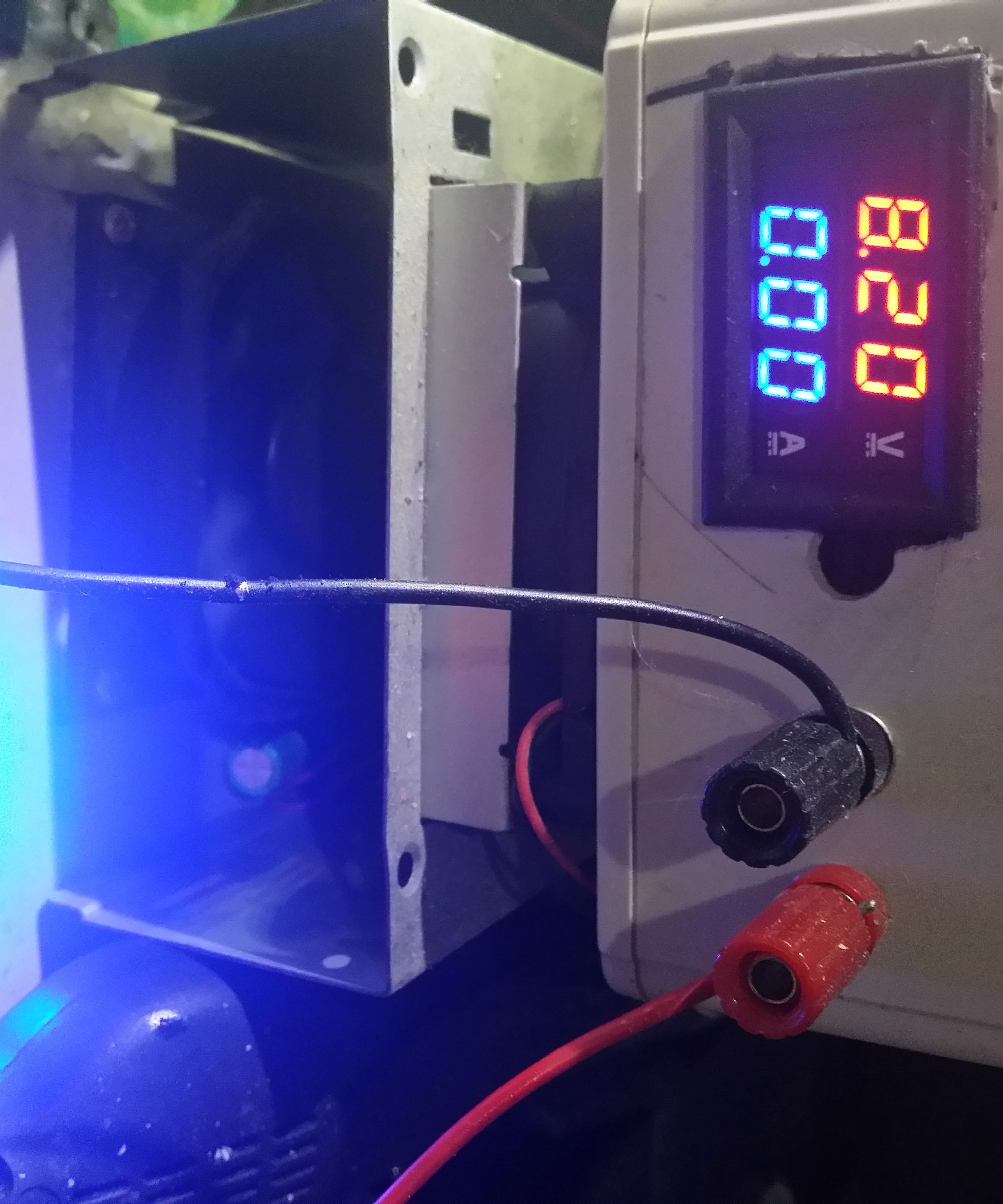

As I said before, I used two 18650 li ion battereis in parralel to get higher current and I used a DC DC boost converter to boost the voltage from 4.2v of the batteries to any voltage I want(I boost it up to 24v). you can see the photo of the boost converter and you can buy it from ebay for 6$ and it is very stable and work perfect. I attached a charging madule with the switch to the batteries, you need to add the swith to the circuit, because durring a charging the circuit shouldn't operate and the switch cut of the connection to the circuit.I also used a small digital volt meter on the boost converter output to monitor the output voltage at all the time. My own made battry pack oparate at list for 2hour continuously without any problem.
