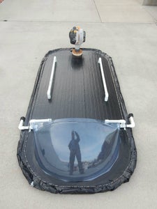

This is our home made, fully functioning, rideable hoverboard! We do not have a propulsion or advanced steering system, but we will share them with you when we add them in the future.
This hovercraft took us a week to put together and get it to work because we had no directions to follow while building. With this instructable, you can build one in a single weekend and cut out all the problems you would encounter if you attempted it using only internet videos as your guide. It can be built for around 50- 60$ if you already have a leaf blower you can use, the rest of the cost is if you need to buy one.

We used tape. It took 2 rolls of black Gorilla Tape to cover the entire surface. We started on the outside edge of the craft and moved to the middle, overlapping a little for good measure. You are going to want to use scissors to cut the strands off because tearing will make your fingers raw very quickly.
Motor Mount:
If you hate taping the leaf blower straight into the hole, just make a mount out of a leaf blower nozzle and a thick piece of scrap wood. First cut the end of a leaf blower attachment that hooks straight onto the blower itself. Cut it so that the open end will extend past the chunk of wood that you are going to put it through 1/2 an inch. Trace the opening on the wood and cut out the circle with the same drill bit you used on the plywood base for the hole. Trace a circular object (or measure two inches from the sides of the attachment and cut a square shape if you want a square) over the hole that will extend past the edge of the hole at least 2 inches. Cut out the ring of wood with a jigsaw and put the attachment through the hole. Put four screws of the appropriate length through the side of the ring or square with the attachment in it so they hold it in the middle and stick through the side of the plastic attachment about a half an inch (see picture 9 of Motor Mount). Cut a circle in the tape around the hole to expose the plywood. Spread wood glue around the exposed wood and stick the mount on. Screw in some screws to secure the mount down over the glue and hole, make sure the leaf blower will be facing the right way when you put it in. Feel the underside of the plastic where you screwed this into the board to be sure no screws are poking through the other side! They will rip your plastic! See the motor mount pictures for reference.
Hand Brakes/Steering:
Be able to slow to a stop and steer a little. Making these out of PVC pipe is super cheap (about $10 for both) and anyone can do it. This is a simple and effective design. You can look at the step-by-step pictures we took to get a clear idea. Be sure to apply glue to every joint when attaching the PVC pipes together. You will need to cut two of each pieces so you can make two handles.
Windshield:
Use a plastic window well cover. The one we used is $20 at Home Depot. Have it be clear plastic and a mostly rounded shape, they have a few models for sale, so choose the one that you think would look best. To get it to be a bit taller and rounder, push in the sides so that it bows upwards. Use half inch screws to screw it down to the plywood then cover the rim in tape that matches your board.
LED Lights:
Having LED light strips is what separated a good hovercraft from an awesome one. Buy a 16 foot strip of your choice color off Ebay for around $10. They come with a sticky side that makes attaching them to anything much easier. Don't be worried about how you are going to get them to light up. The best cheap way to do it is buy a 9V battery. They are the box ones with two nodes on the head. Just touch the two exposed wires dangling off the end of your light strip to these and they will instantly light up! It may not be quite as bright as powering the lights with a 12v power source, but they look bright enough to me. Use any tape to secure the wires to the battery.
Rails:
Cut two of each lengths shown in the rail image to make two. Measure 7 inches from the sides and mark where the end caps for the rails will be. Drill three holes in the end of the caps to allow screws to fit through. Screw the ends down, then build the rail on them, glue the pieces together as you go. Use the images for reference.
