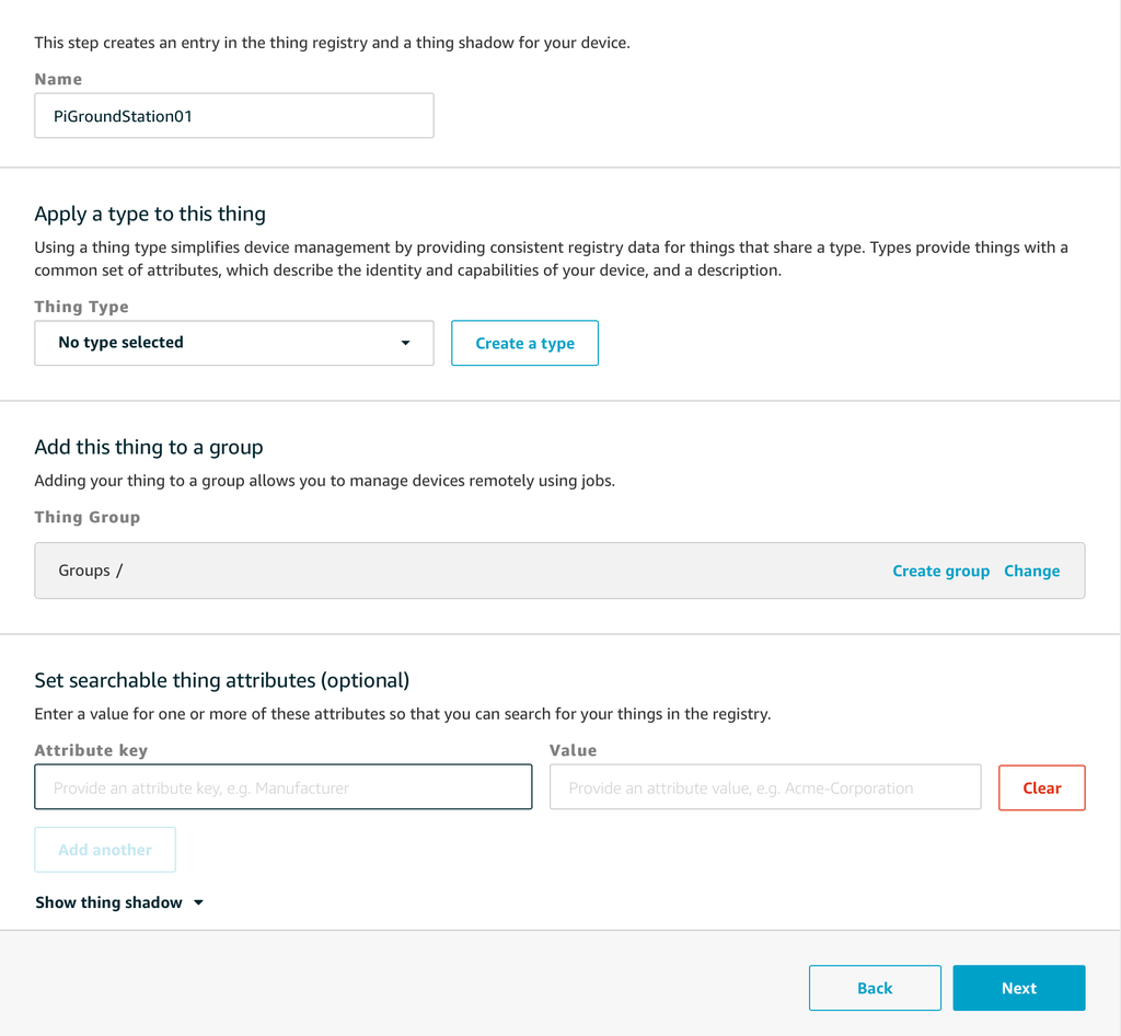

- Select Manage >> Things and selectRegister a Thing
![](https://content.instructables.com/FXF/IVNO/JDKKMTRR/FXFIVNOJDKKMTRR.png?auto=webp&fit=bounds&frame=1&height=1024&width=1024)
- On the next screen click Create a single thing
- Give your thing an appropriate name, I called mine PiGroundStation then click next.
We've now create a Thing for our Internet of Things. Next we need to set up a certificate and a policy to provide our thing and lamda.

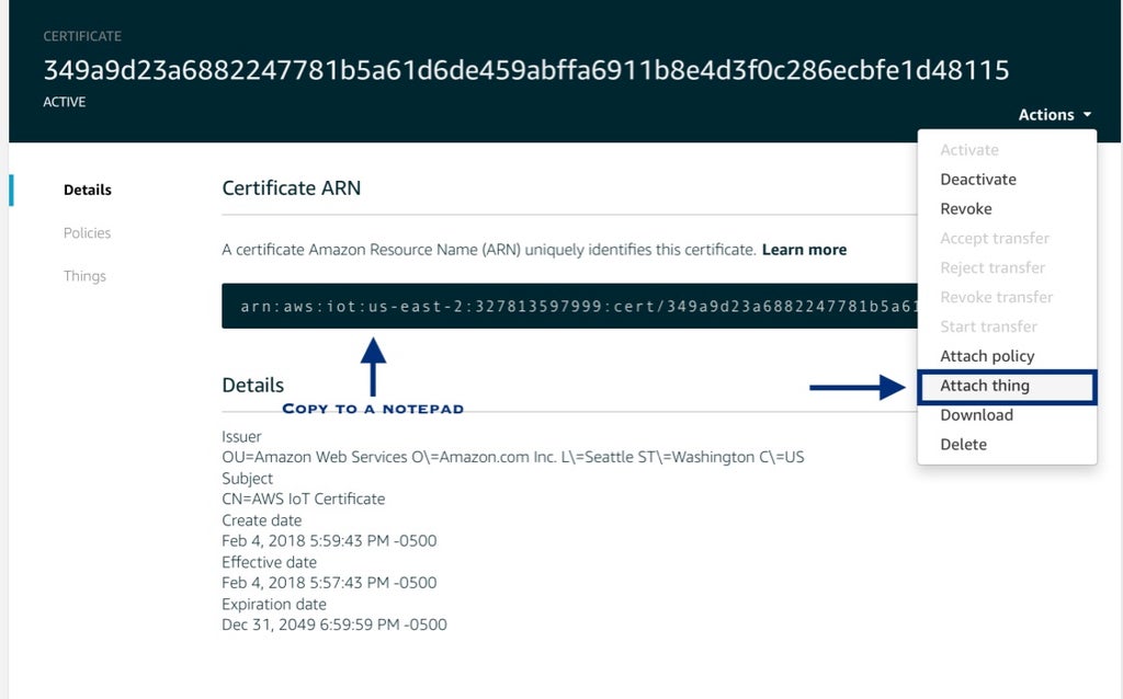

Continuing on from the AWS IoT Thing wizard, we will create a certificate.
- Select Create Certificate
- Then, download all of the files, certificate, public key, private key, and root CA. Save these files to a safe place as we will need them later when configuring our ground station so it can communicate with AWS.
- Navigate to the Security tab and find your certificate. Then, select attach a thing, select your thing, and attach it the certificate to the thing by clicking attach. Note the Certificate ARN, copy it to a notepad as we will need this later.

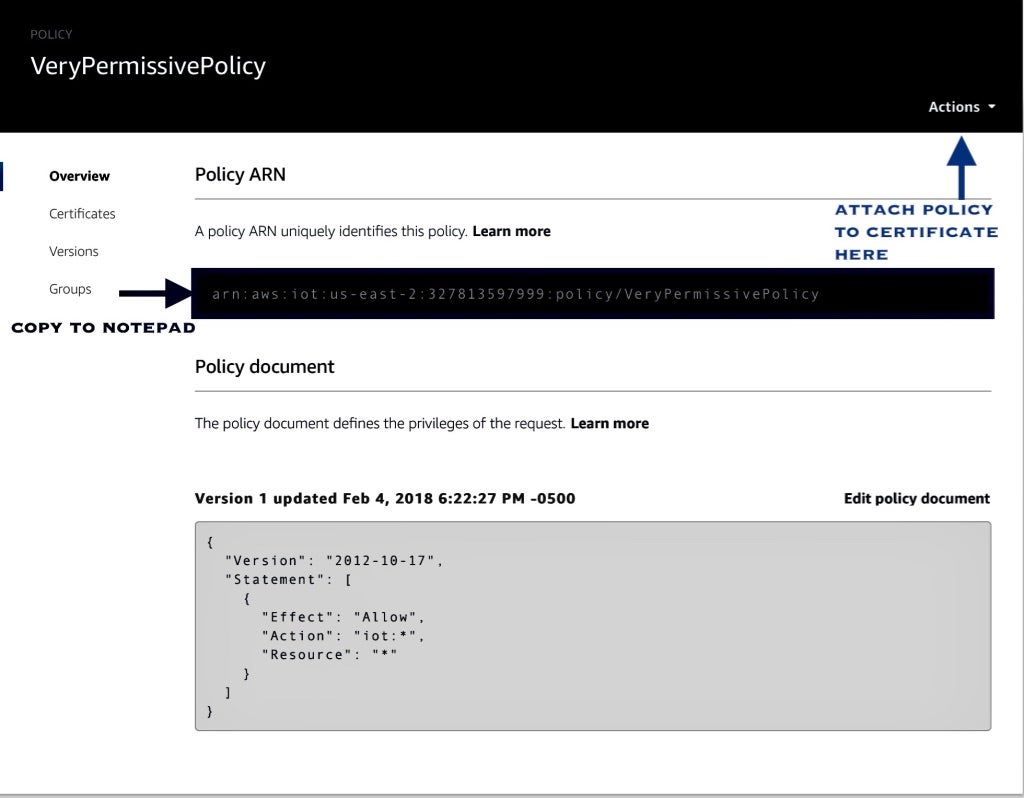

Step 37: Creating a Policy
The Thing and the Lambda ideally would each have their own policies. For the sake of the demo, we will be creating a very open and permissive policy that can be used by both the Thing and the Lamda.
- Under the Secure>>Policies tab, select create a policy
- Name the policy appropriately, I named mine very_permissive_policy
- Assign action as iot:* and resource arn as *
- Select allow for effect and click create.
- Once done, like in the certificate step, attach the policy to your thing. Note, the Policy ARN, copy this to a notepad.

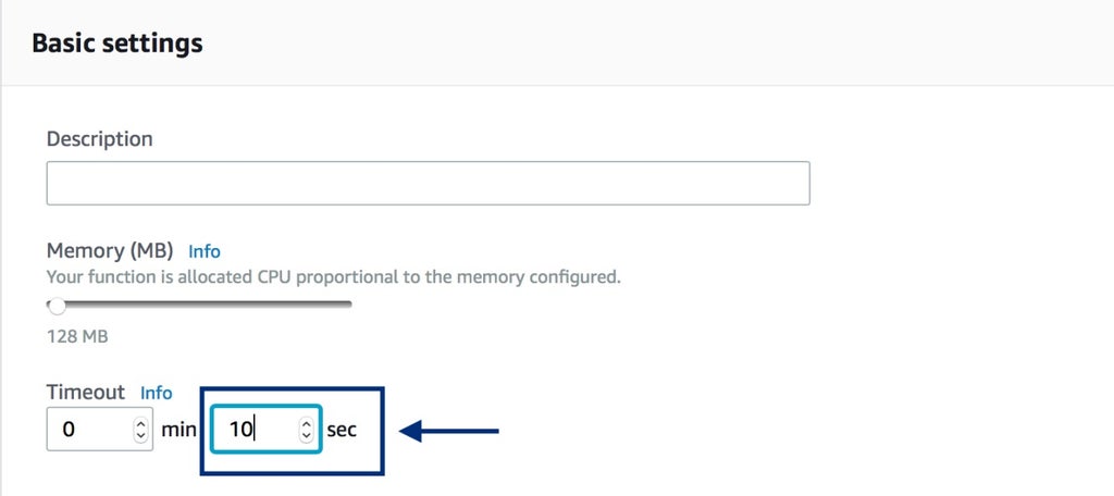

- Navigate to the top panel and select Services>>Lamda. Then click, create Lamda function.
- Under the create function window, select Author From Scratch. Assign it the name EchoDroneControl, as this will need to match the name of the directory on the Raspberry Pi. The runtime will be Node.js 4.3.

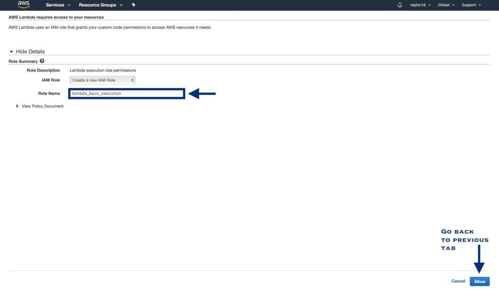

- Select Create a Custom Role; this will open a popup window and assign it a role name lambda_basic_execution. Click Allow on bottom of Lambda Role page.
- Back at the Create Lamda Function page, Leave the other options at their default value except Timeout, increase this to 10 seconds. Then click Next.

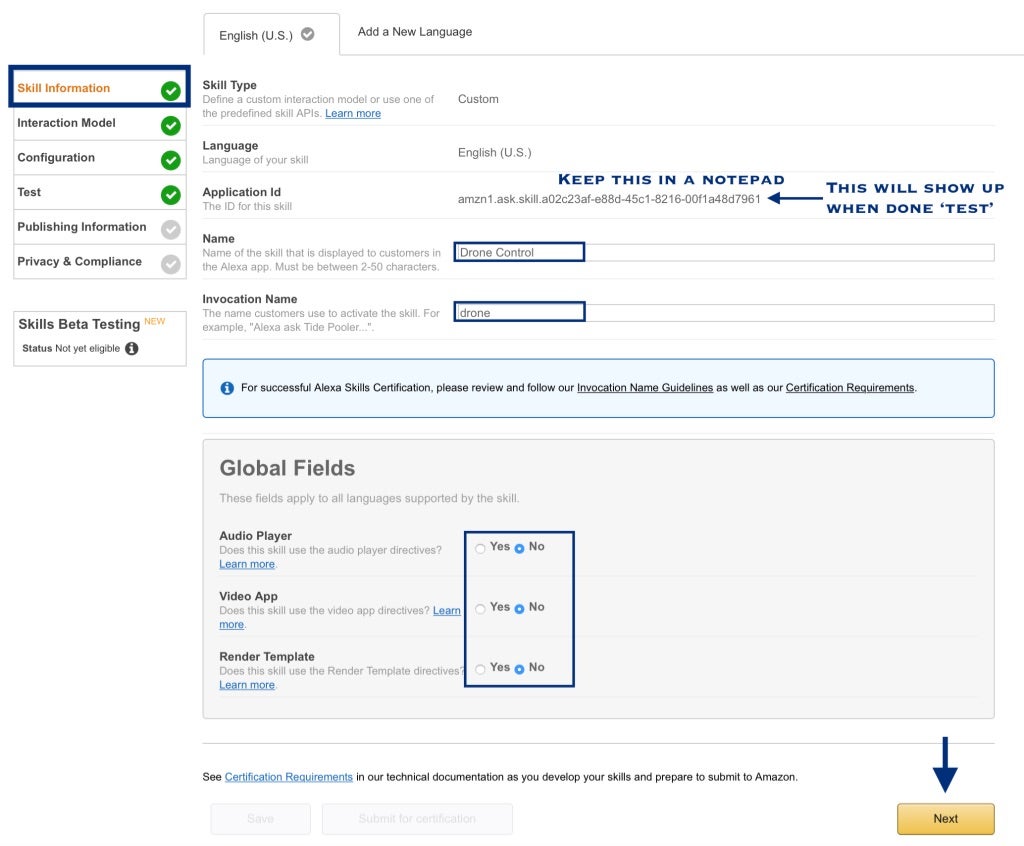

Step 39: Creating a New Alexa Skill
Create an account with the Alexa developer portal. This is where we will create our custom alexa skills.

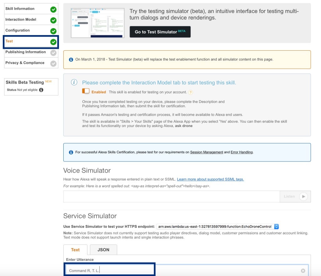

- At the top bar, select Alexa Skills Kit>>Start a Skill.
- Give your Alexa Skill an appropriate name and invocation name. I used Drone Control and Drone for the name and invocation name of my skill, respectively. Then click Next.
- Copy the intent schema code to the text block.
- Copy the sample utterances code to the bottom text block. Then click Next.
- Copy and paste the ARN link that you kept in the notepad in previous steps, then click next.
Now, before testing out the skill we need to setup the ground control station in with which the lambdas will communicate in the next step.

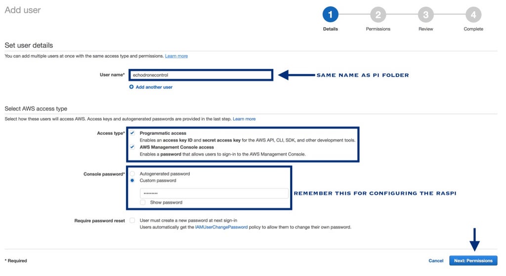

- Open the IAM console and set the user details as shown below
- Under the roles tab, attach the policies shown in the image below and click Next.These will be used to run the configuration file on the ground station.

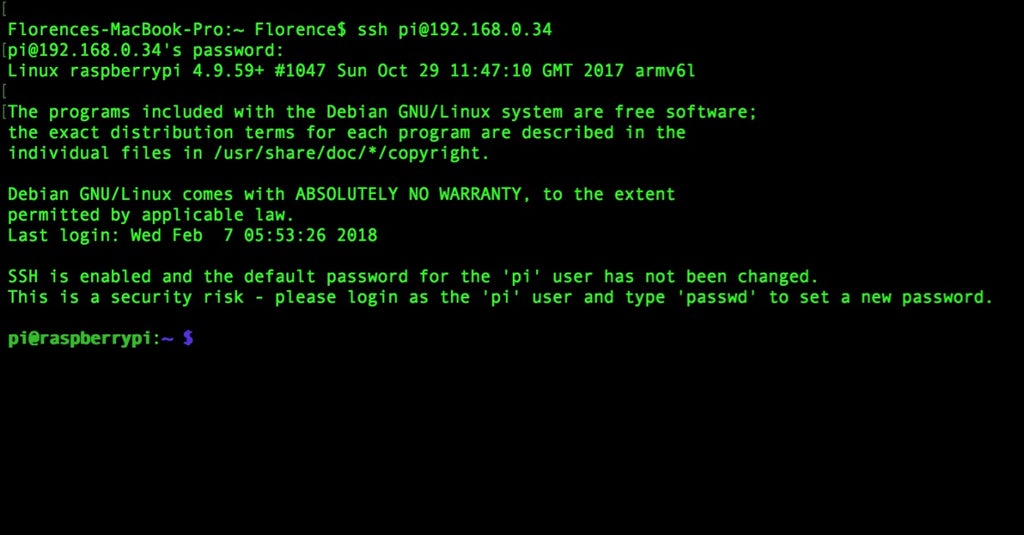

- SSH onto the raspberry pi and login with the default password raspberry.
- Enter the following commands onto terminal once logged in
cd ~<br>sudo apt-get install avahi-daemon sudo chown pi /usr/local/ -R sudo apt-get install nodejs npm -y sudo apt-get install zip sudo apt-get install screen pip install awscli pip install dronekit pip install paho-mqtt git clone <a href="https://bitbucket.org/veggiebenz/echodronecontrol/">https://bitbucket.org/veggiebenz/echodronecontrol/</a> dronecontrol cd dronecontrol mkdir certs<br>

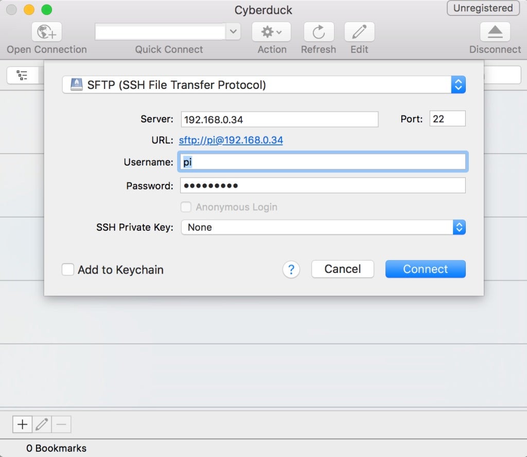

- Download Cyberduck, an SFTP app which allows the transfer of files to and from the raspberry pi.
- Login in to the Raspberry pi on Cyberduck with default username pi and password raspberry.
- Transfer the certificates to the certs folder.
