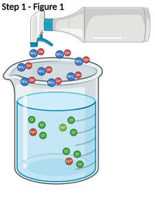

As seen in figure 1 of step 1, the solution in the reaction vessel consists of a ratio of two iron salts: ferric (Iron (III)) chloride (FeCl3), and ferrous (Iron (II)) chloride (FeCl2). These form a ratio of 2:1 because magnetite, Fe3O4, is made of two Fe3+ ions and one Fe2+ ion. This ensures that all the iron will be converted to magnetite, and not other non-ferromagnetic side products. To this (rapidly mixing) solution, ammonia (NH4OH) is added through a spray bottle. This is to disperse the ammonia as much as possible and in combination with the rapid mixing, form as small of particles of magnetite as possible
As seen in figure 2 of step 1, the ammonia reacts with the iron chlorides, forming magnetite (Fe3O4) and a large amount of ammonium chloride (NH4Cl) salt. This salt is essentially inert and is left in the solution throughout the duration of the procedure. Half of the hydroxide ions (OH-) that were originally bonded to the ammonium ions (NH4+) split to become oxide ions (O2-) and free protons (positively-charged hydrogen (H+) ions). The protons bond with the other hydroxide ions to form water (H2O), and the oxide ions form ionic bonds with the Iron ions to create the magnetite.
Figure 3 of step 1 represents the now-formed magnetite particles in the solution, which must be kept mixing until they're stabilized with surfactant in the second step.

4. Prepare ~60g (42.6g stoichiometrically, [0.24M of NH4OH] rounding up for excess) of a 10% solution of ammonium hydroxide (by mass) and dilute to about 100-200mL. Add it to a spray bottle and set nozzle to a fine mist.
5. Cover the beaker if possible, and using a (preferably mechanical) stirrer, begin stirring the iron chloride solution as quickly as possible without causing significant surface splashing (attempting to prevent further oxidation of the Fe2+ ions into Fe3+ from dissolving oxygen gas).
6. Using the spray bottle, quickly add the ammonium hydroxide, attempting to distribute the mist across as much surface area of the solution as possible. Color should transition from light yellow/orange to dark orange to brown, to black, becoming increasingly opaque. This step should be completed in under 2-5 minutes. Ensure pH of solution is above 9-10 and stop even if the bottle isn’t empty when the target pH is reached.
7. Add the prepared Mixture B, ensuring it mixes well with the solution. Allow it to mix for 2-3 minutes or until the solution is visibly homogenous, whichever occurs later.
8. Ensuring no visible changes are occurring, begin adding Solution C via spray bottle in the same way ammonium hydroxide was added. Fumes of ammonium chloride will be generated, but are harmless. As pH decreases below 7, the solution will visibly change. Black precipitate should begin coagulating and separating from solution, leaving a cloudy but colorless solution (of unbonded oleic acid and ammonium chloride). Continue adding hydrochloric acid until pH is around 5 to ensure all ammonium oleate has been destroyed, at which point turn off stirring.
9. The nanoparticles are now stable, and synthesis is complete.
