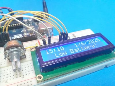

Case the voltage value is less than 1.5V, the system will alert the user, to inform a voltage low level of the battery.
Step 2:
Hereafter, we present the screen with an alert message of a low level of voltage in the figure above.

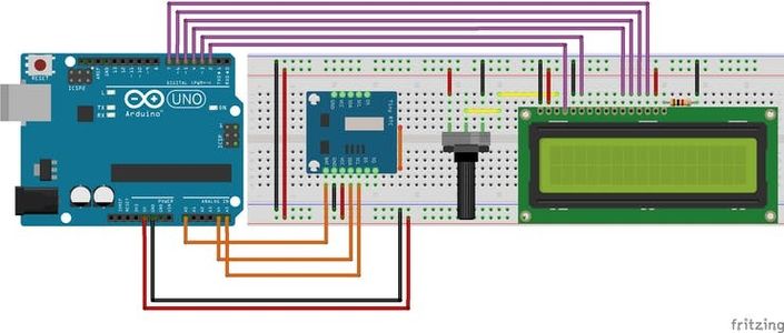

Now, we will present the step by step process to construct a simple project using Arduino UNO.
To construct this project, you need to use this circuit presented in figure above.
Through this circuit, see that in the Real-Time Clock module have a pin named VBat.
With this pin, we connect in the analog pin AN0 to verify the battery voltage and to inform in LCD 16 x 2.

If the voltage value was less than 1.5V, the LCD will present a message of Low Battery, as is presented in Figure above. In this way, the user will be alerted by the system.

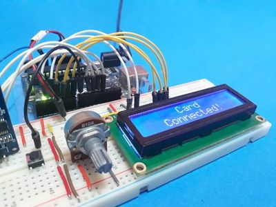

Now, case the battery is with voltage more than 1.5V, the LCD will present the date, time and voltage of the battery. This is presented in the figure above.
