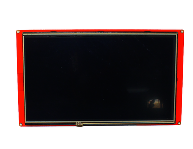

ESP32 Dev Board-1-Any generic ESP32 board
Nextion Display-1-I used 10-inch model
USB cable + 5V supply-1-For powering ESP32 and/or Nextion display
Jumper wires-Several-For TX/RX and power connections
Optional: Micro SD card-1-or uploading Nextion .tft file
Step 1: Hardware Wiring
Connect the ESP32 to the Nextion display:
  1. Nextion TX → ESP32 GPIO17 (RX2)
  2. Nextion RX → ESP32 GPIO16 (TX2)
  3. VCC → 5V
  4. GND → GND
  5. Make sure TX goes to RX and vice versa.
