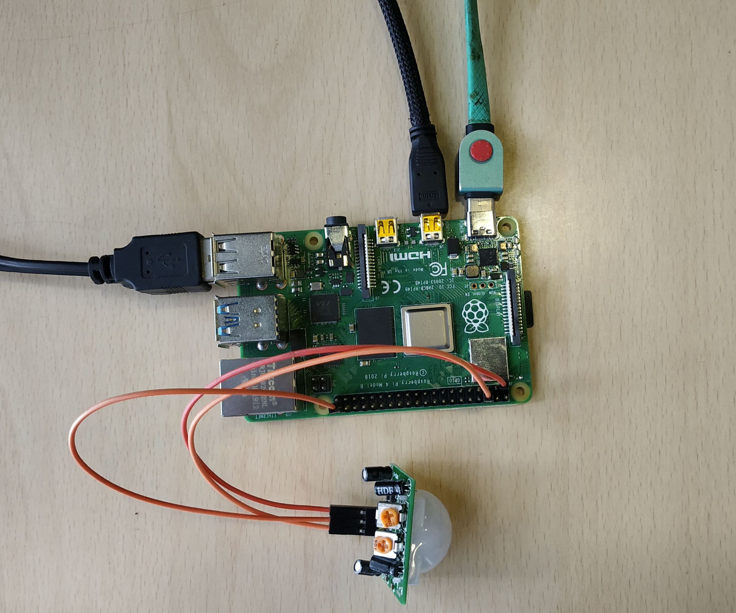

As shown in the picture above you need to do the following things:
1) Insert micro SD card into Raspberry Pi 4.
2) Connect mouse & keyboard to Raspberry Pi 4.
3) Connect Monitor to Raspberry Pi 4 via micro-HDMI
4) Connect the USB Webcam to the Raspberry Pi 4
5) Connect the power cable and Power ON the Raspberry Pi 4.

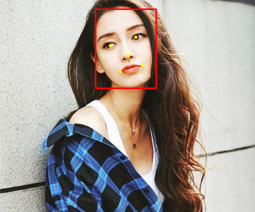

The given code captures frames continuously using Opencv's VideoCapture function. These frames are given to the detect function of Shunyaface which in turn returns the frames with bounding box plotted on the face and dots plotted on the eyes, nose and end points of the lips. To quit the code press the "q" button. After pressing "q" the Output FPS is displayed on the terminal.

You should now see a window open. Whenever a face is in front of the camera, it will plot the bounding box and it will be visible to the user on the window that opened.
