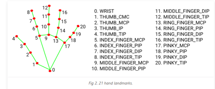

So basically, we get frames as input from our webcam and we will pass the images of the frames as img. We will pass img to the functions 'findHands()' and 'findPosition()' of the class 'handDetector()'. findHands() will detect the hands and findPosition() will output the coordinates of our finger joints. We will use these coordinates to determine whether the finger is closed or not. The coordinates of the finger joints are stored inside a list called lmList. first we need to look at the attached pic of the numbering of finger joints.
This numbering is same for left and right hands. In order to check whether a finger is up or down, we need to access the Y coordinate of the finger joints. For eg :- We want to check whether the index finger is up or not. The concept is that, if the tip of the index finger(8) is lower than point 6, the finger is closed i.e. if Y coordinate of point 8 is more than point 6, index finger is closed. However, this doesn't hold true for the thumb. To determine whether the thumb is closed or not, we need to check if the X coordinate of point 4 is less than point 3 or not (in case of right hand). if X coordinate of 4 < X coordinate of 3, thumb is open else it is closed. The reverse occurs in case of left hand thumb.
To determine whether a hand is right or left, we will be using a very simple concept. The webcam will mirror our hand and there will be a lateral inversion. Hence, if the pinky finger is on the right of ring finger, it is a right hand else it is a left hand. That means, if X coordinate of point 20 > X coordinate of point 16, it is right hand, else it is left hand.
