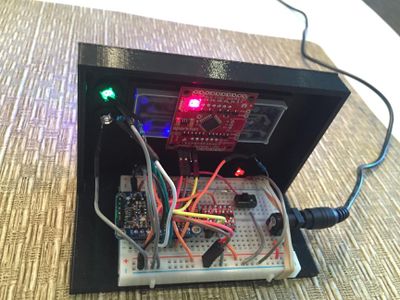

Step 4: Assembly
Assembly is very straightforward. Wire up the electronics on the breadboard as shown in step 2. The image above shows that actual wiring usually looks a lot messier than the diagram.
I soldered the 220 Ω resistors directly to the positive legs of the LEDs to keep wiring simpler. Then stick the breadboard to the back platform of the stand, and push the LED holders through the holes in the front panel. Then push the LEDs into the holders. The 7-segment LED display fits inside the rectangular hole in the front. I didn’t even have to glue it into place. A rubber band helped secure a barrel-jack connector to the breadboard to transmit power from the 6V wall adapter.
