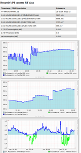

The Belgian ( and others) electric counter has a standard serial P1 connector who give a continuous stream of 'telegram' who contains the full operational data of the counter.
This 'telegram' is read by the Raspberry Pi, and
  1. a call is made to a server
  2. a record is send to ThingSpeak
the server push the data to a RRD table and request RRDTool to build hourly, daily monthly graphs.
( The Raspeberry Pi only is sufficient to push the data to Thingspeak. )
The Raspberry Pi and the server keep the programs as service, so they restart automatically.

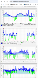

  1. You need to install LAMP (WAMP, change the folders names) on server side to use the
http://localhost/rrdpower/index.php
graphs as illustrated
