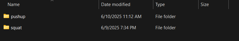

  7. Exported labeled data in YOLO format, ensuring consistent folder structure and naming (train/val/test with /pushup and /squat in all of them).

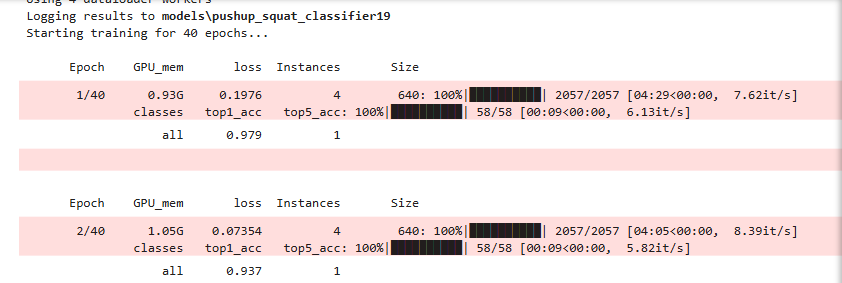

  4. Model Training:
model = YOLO('yolov11n-cls.pt') # lightweight for faster inference
model.train(data=data_path, epochs=40, imgsz=640)
  1. Export and Test:
  2. Saved the best model as exercise_classifier.pt
  3. Verified performance on test images and confusion matrix.
