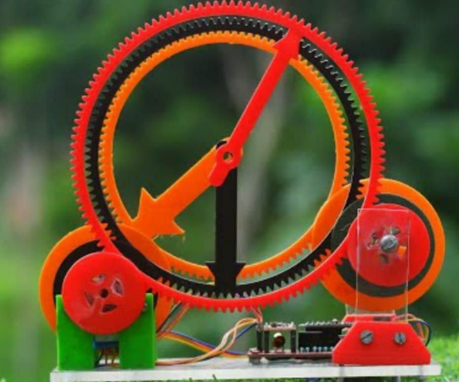

This is an amazing clock. This clock do not have any display to display the time like other traditional clocks, neither it is an analog clock.
This clock uses an RTC module to track the time which is translated to the servos that writes the real time using a marker pen. This clock also has the capablity to erase previous time.
