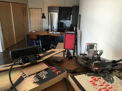

Below you can see my setup:
Figure 1: My the Raspberry Pi 2 + USB webcam + Pi camera module setup.

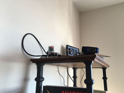

Here is another angle looking up at the setup:
Figure 2: Placing my setup on top of a bookcase so it has a good viewing angle of my apartment.
The setup is pointing towards my front door, kitchen, and hallway, giving me a full view of what’s going on inside my apartment:

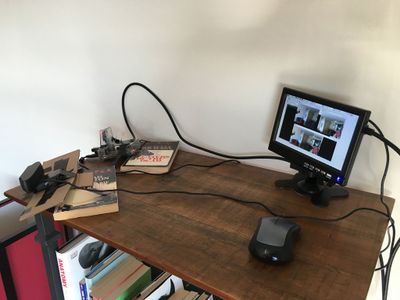

Figure 3: Getting ready for real-time panorama construction.
The goal is to take frames captured from both my video streams, stitch them together, and then perform motion detection in the panorama image.
Constructing a panorama, rather than using multiple cameras and performing motion detection independently in each stream ensures that I don’t have any “blind spots” in my field of view.

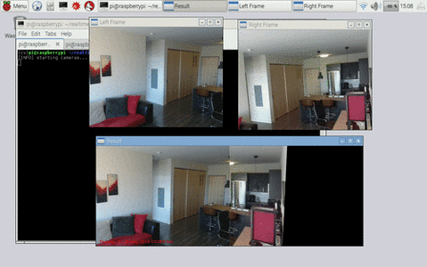

Below you can find an example GIF of my results:
Figure 4: Applying motion detection on a panorama constructed from multiple cameras on the Raspberry Pi, using Python + OpenCV.
On the top-left we have the left video stream. And on the top-right we have the right video stream. On the bottom, we can see that both frames have been stitched together into a single panorama. Motion detection is then performed on the panorama image and a bounding box drawn around the motion region.
