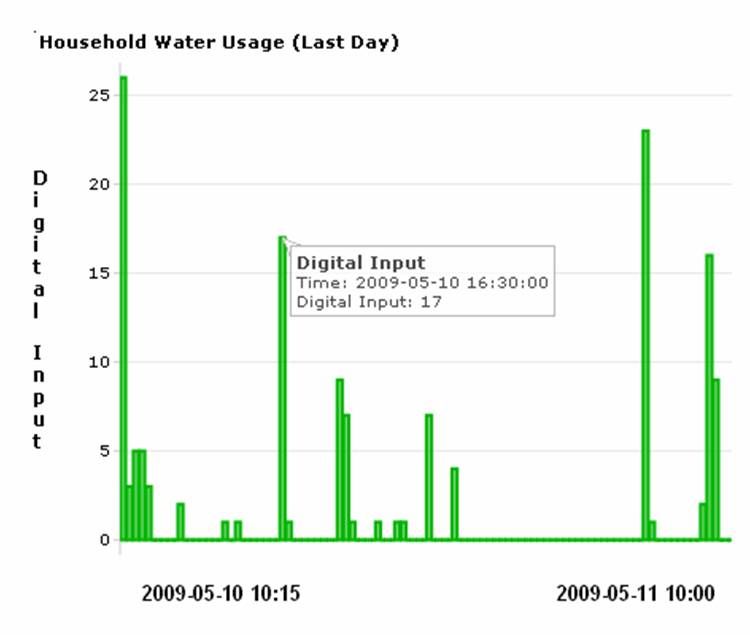

Step 10: Google Charts and Website Integration
Since describing how to use Google Charts and javascript could be an Instructable of its very own, I'm not going to cover that in much detail. Basically, I ripped off a few other examples I found on the web and modified them to fit my needs. I'm providing a link to the source code of my original power charting webpage. If you make the system as I have described, then you should be able to replace the ioBridge widget embed code(s) in my html with your own.
There are a few features of the chart that I'd like to point out. First, it automatically updates every 10 seconds. It will continue to add more points for an hour. After an hour, data older than an hour will be scrolled off the chart to make room for new data. This limitation is because of the way Google Charts works. A Google Chart is created through the use of a URL. Since a URL is limited to 2048 characters, there is a limit on the amount of data that can be plotted at once. The other thing I want to mention about the chart is that it will automatically scale the Y-axis.
