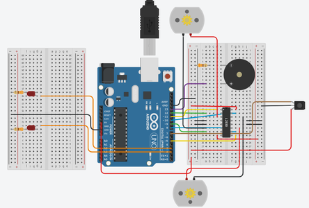

Step 2: Wiring Components to Arduino
The next step would then be to connect your components to the Arduino Uno. First place the Arduino and breadboards on the car chassis in a way that would make the car look good and realistic. After making sure they are all secure, start making connections between the components and the Arduino.
Connect the DC Motors to the H-Bridge (with the output pins) while also connecting 5V and ground from the Arduino into one of the H-bridge breadboard power rails as it will be needed for the H-bridge to function (in the image, we connected 5V to the left rail and the right rail will be used for the 9V Battery).
Make sure your enable pins are connected to analog pins because they will be using PWM to control the speed of the motor. Everything else can be connected to any pin (either digital or analog). Also connect your components to ground and power (if needed), making sure that the power source is from the Arduino, otherwise they will be damaged later on!
Make sure that both of the VCC pins of the H-Bridge is connected to the correct power source (VCC 1 should be connected to the 5V power rail while VCC 2 should be connected to the 9V Power Rail) as it will be using two of them (Arduino and 9V Battery). Overall, this step is for the connection of the components to the Arduino and wiring the power connections correctly.
Color Coding:
- Green Wires - Control Pins for Right Motor
- Blue Wires - Control Pins for Left Motor
- Yellow Wires - Enable Pins for H-Bridge
- Orange Wires - LED Pins
- Purple Wire - Buzzer Pin
- Brown Wire - Signal Pin for IR Receiver
- Red Wires - Power or DC Motor Connection
- Black Wires - Ground or DC Motor Connection

Step 5: Connecting 9V Battery
The last step is to connect the 9V Battery. Connect the Battery Cap to the Battery and place the red wire into the positive side of the power rail and the black wire to the negative side of the power rail (in our case, the 9V Battery power rail is on the right; stated in step 2). Then connect the grounds of each power rail to each other.
Make sure the positive side of the power rail for the Arduino and Battery are NOT connected, only the negative sides. Otherwise you will fry the device where you are plugging your Arduino into! I recommend taping the battery to the car, as it will probably fall off and the motors will stop moving.
Now upload your code into the Arduino and the car should be fully operational. Try pressing the buttons that you tested for and see if the car begins doing its corresponding action. If the wheels are moving in the wrong direction, switch the DC Motor wires in the H-Bridge (for example, if the wheels are moving backwards instead of forwards).
