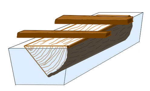

When making a gelatin mold, you will use a container that will hold the gelatin while it sets with your log just beneath the surface. To be able to do so, you log will have to rest at the surface of your container and the gelatin will need to fill all your container space.
Once you have a flat surface on your log, you will nail some wood sticks to it and set it upside down in your container.
I'm sorry I don't have a picture of this step, so I created these award winning pictures instead. Photoshop king here, I know.
The first step is to determine how much gelatin you need to use.
For that you need to know the amount of water that will be used inside de container. The best way to do so is to put your nailed log into its container with the wooden beams resting across the top of the container.
  • Fill the container with water, making sure that the log doesn't float on top. You can put some weight on it to keep it submerged. Be creative here ;)
  • You can now remove the log and weigh the water. That would give you the volume of gelatin that you need to fill the container with.

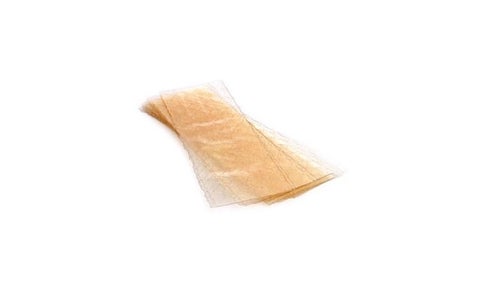

  • To know how much dry gelatin you need to use, we could go into details on what kind of gelatin and whatnot but you can count on a a small recipe to give you a strong gel.
  • Divide the weight of water by 2 that will give you the weight of water that you need to boil.
  • Once boiling remove from the stove and add the same amount of sugar. stir to dissolve
  • Add half of this weight in gelatin. That's a lot. Bloom it beforehand in cold water and stir to dissolve.
  • If need be, you can reheat the pan but don't boil it.
If you're really bad at maths, it means that If you measured one kilogram of water, that would mean 500g of water, 500g of sugar and 250g gelatin (125 standard 2g gelatin sheets - buy it by the kilo). If you use imperial, I'll let you do the math.
If the gel is too soft it won't hold. If it's too strong it will break apart when you'll remove the log. This ratio is about right for what we try to achieve here.
