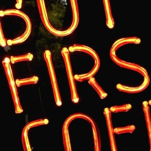

Step 1: Inspiration and Rough Idea
BUT FIRST, COFFEE!
So true, so true. I saw this awesome neon sign for sale at a design shop, and knew I had to have it. I mean, I had to buy it for my wife as a gift.
Either way, she wasn't gonna spend $350 on a frivolous sign, no matter how cool. (True glass-formed neon signs are still hand-made, and so really expensive)
So I found clear plastic tubing in the hardware shop, used for aquariums. It seemed just the right diameter for neon lettering, so I bought it! Paired up with RGB LED strip, I was sure I could make this work.

Step 8: Enjoy!
Ta-daa!
I usually hate RGB LEDs, and would stick to warm white wherever possible. But the 'tacky' colours really sell the idea that this is a neon sign. (Of course neon signs can't change colour as the gases in each tube only emit a certain frequency light by their inherent physical properties... but let's ignore physics for a moment)
I think this looks the closest to a real 'Neon' sign of all the simulated techniques I've seen. It looks like a glass tube, with real depth.
I've put this sign on a timer so that it comes on every morning, and draws me with its alluring glow to my first cuppa joe.
Hope you like this, and if you find it useful, please do vote for me in the "Faux Real" contest! Thanks!
