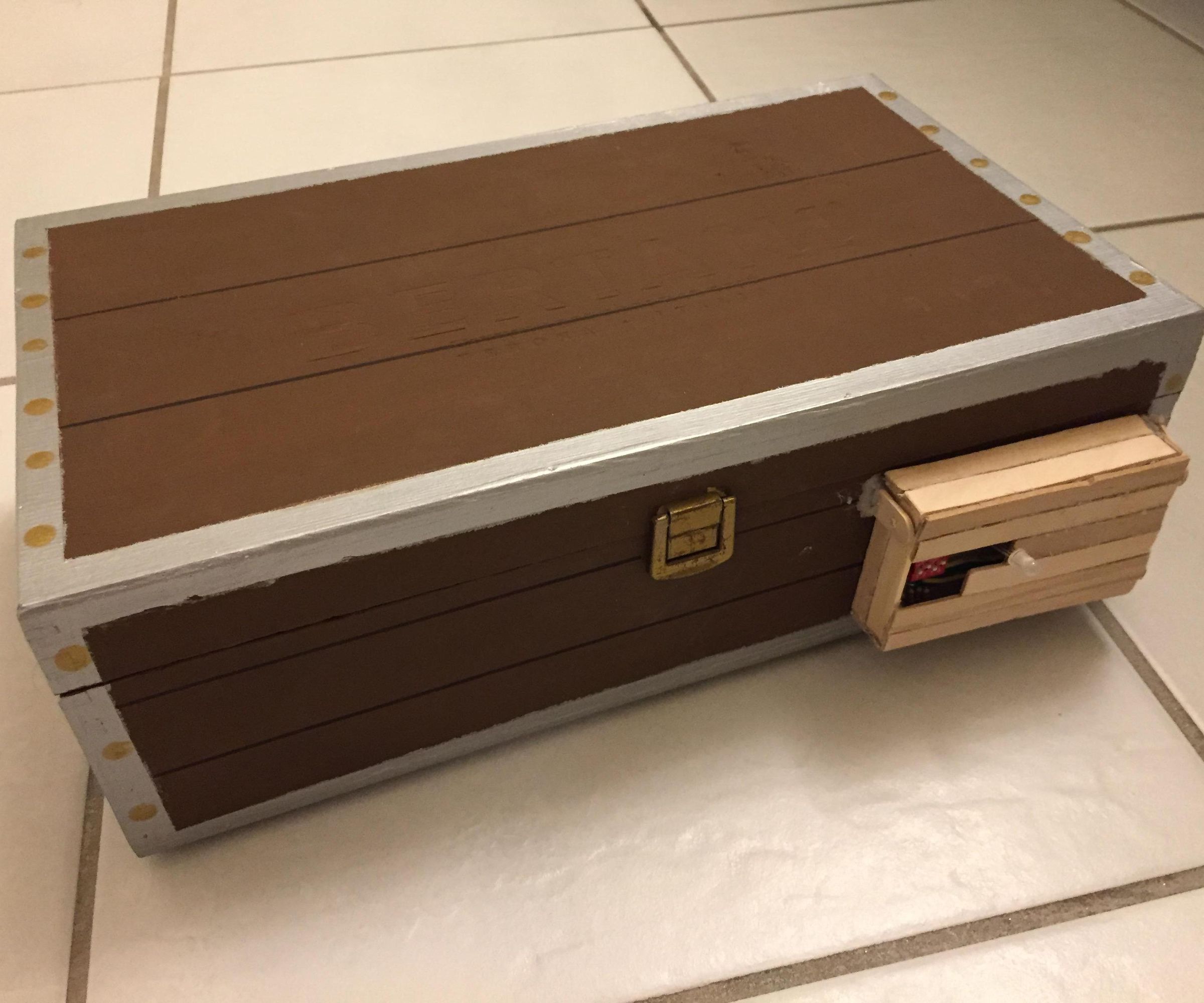

Introduction: Realistic RC Car
In this instructable you will learn how to wire the necessary hardware for a realistic RC car. Well what is a realistic RC car? This means it is a RC car that is realistic to a real automobile, it features four wheel drive, a fuel level indicator, and functioning headlights with indicators and hazards. This is a rather large project, so the instructions will be split into 3 main sections, the very first step is to gather all the supplies listed below.
