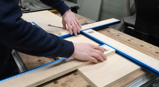

This is how I made a REALLY EASY!! - DIY - ADJUSTABLE ROUTER TEMPLATE This is a must have tool in and wood shop! This router template is used for routing dados in wood, and routing square or rectangular shapes, it is extremely useful and can be made in an hour with basic tools

Step 7: Assemble Bolt Section
Assemble the T-bolt sections as per the photo
Step 8: Mount T-Track
Mount the T-Track on the edge of one side of each piece of the plywood.
Use the self entering drill bit to pre drill the holes this will help the wood to not split when you drive in the screws!
Step 9: Assemble!
Put your Template together!
Step 10: Stick on Rulers
Stick on your 4 Sticky tape rulers. They are metal but you can snap them easily by folding them over a straight edge. I tried to show myself doing this step in the photos but it makes a lot more sense if you see it in the video I have embedded at the top of this instructable.
Step 11: Used Your Template!
