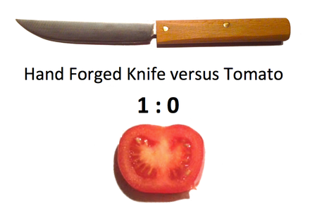

A very simple knife forged on the Folding Chair Charcoal Forge we published earlier. Apologies for the relative dearth of images, did not manage to photograph every step, however should give an idea of what we did. The knife works very well, as the video of the tomato shows.

Step 4: Hand Forged Knife Versus Chilled Tomato
Trying out the knife on an unsuspecting tomato
