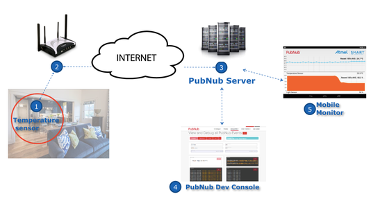

Step 1: The Concept
- The Atmel I/O1 Xplained Pro sensor measures the ambient temperature.
- This connects to the Wi-Fi using the ATWINC1500 module.
- The PubNub code running on the Atmel chip enables us to publish the temperature in real time to any one subscribing to the same channel as a data stream.
- Through the PubNub Developer Console, you can receive this stream of information from as many sensors as you like in realtime to our live-updating chart (powered by EON).

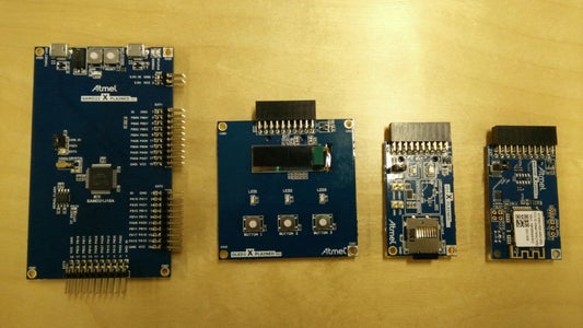

Step 2: Hardware
- ATSAMD21-XPRO host MCU board.
- OLED 1 Xplained Pro to provide the display on the chip.
- Atmel I/O1 Xplained Pro for sensor and SD-card input to host MCU
- ATWINC1500 module. This is a Wi-Fi black box that contains the Wi-Fi stack, the TCP stack and the TLS stack.

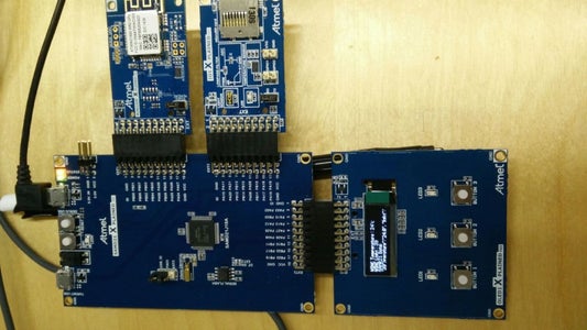

Step 4: Connecting the Hardware
- Connect WINC1500 XPRO board to SAMD21 XPRO connector EXT1
- Connect I/O1 XPRO board to SAMD21 XPRO connector EXT2
- Connect OLED1 XPRO board to SAMD21 XPRO connector EXT3
- Connect SAMD21 XPRO to a free USB port on your PC (make sure no other USB port on your PC is in use)
- Connect the power to the port that says “DEBUG USB”

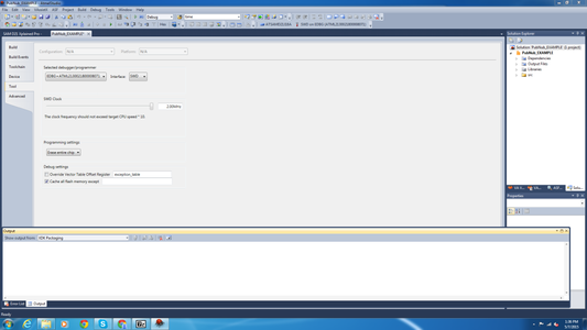

Open the PubNub example: pubnubAtmel/PubNub_EXAMPLE.atsln (included in the code download) in Atmel Studio and you will see the following page. Make sure you choose the debugger/programmer and interface as shown in the image

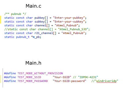

Step 6: Include the Following Lines in PubnubAtmel/src/main.h
#define TEST_MODE_SSID "Enter-your-SSID" (choose THE Wi-Fi access point you want the chip to connect to) #define TEST_MODE_PASSWORD "Enter-the password-for-the-SSID" (enter the password for the same Wi-Fi connection) #define TEST_MODE_WITHOUT_PROVISION
Step 7: In PubnubAtmel/src/main.c, Add the Channel Name and Pub, Sub Keys.

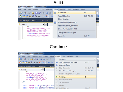

Step 8: Build (F7 / Build -> Build Solution), Run(continue/ Green Arrow/ F5/ Debug -> Continue).
