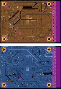

Step 2: PCB
PCB Layout

Now that we’ve got the PCB design, it’s time to order. For that, you just have to go to jlcpcb.com and click on the “Instant Quote” button.
You don’t have to worry about the settings here, because you can adjust everything in the new appeared tab.
JLCPCB is also a sponsor of this whole project (not only this PCB but all the PCBs in the car!). JLCPCB (Shenzhen JLC Electronics Co., Ltd.), is the largest PCB prototype enterprise in China and a high-tech manufacturer specializing in quick PCB prototype and small-batch PCB production. You can order a minimum of 5 PCBs for just $2 (2 layers), just enough to have a few test/spare ones. To get the PCB manufactured, just upload zipped Gerber files.
Then, you have multiple options to adjust the number of layers to your PCB color. Every option here is very clearly marked and described (when you hover over the question mark).
After making sure your PCB looks good – by clicking Gerber Viewer, you can now place the order at a reasonable price. In the case of this project, there is 2$ for 5, 2-layer PCBs and it’s only 3-4 days build time(the time is extended due to the chosen color). To place the order, click on the “SAVE TO CART” button. Fast and cheap, right?
The quality is always really satisfying so I sincerely recommend JLCPCB.
