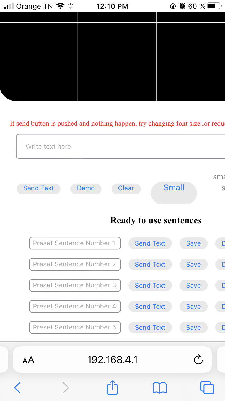

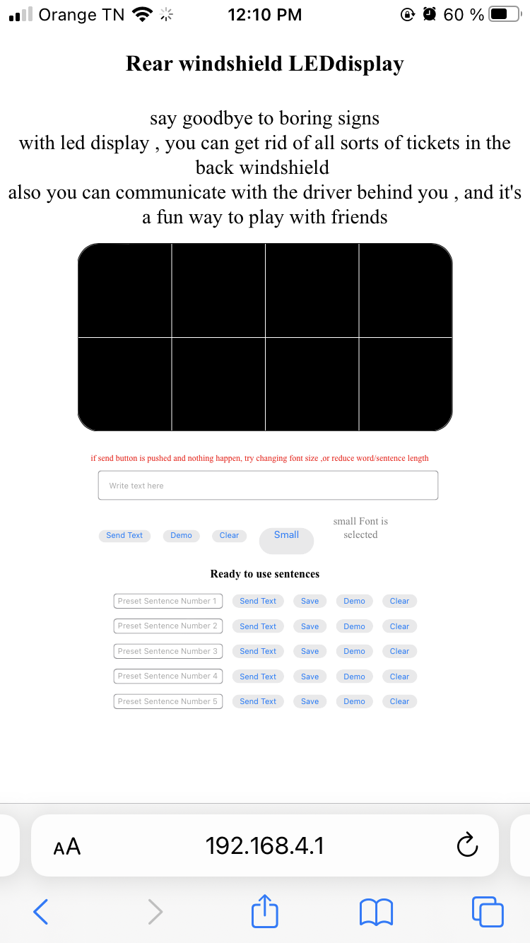

Now, let's continue. The ESP32 has wireless capabilities like Wi-Fi, which we'll use to communicate with the board via a web browser on our phone. The ESP32 will receive commands from the browser and send them to the LED matrix driver chips to display the desired message.

Feel free to get creative! You can adjust the font size in your web browser—for the big font size if the text gets too wide, it’ll automatically scroll. To start, just type the IP address of the ESP32 into your browser, usually 192.168.4.1, and you will land on its web interface,and type whatever comes to your mind
So go ahead, have fun with it! Write some funny sentences, and even make a few call videos. Don't forget to share them in the comments so everyone can enjoy them!
