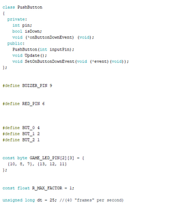

For this project, you will also need to be able to plug your Arduino into the computer. Once you have plugged the Arduino into the computer and opened the software go to tools on the top right and select ports. Make sure that your Arduino UNO is showing on the port. After you have done so you can copy and paste the code that is provided with the TinkerCad. Next, click the arrow in the top left and save your work. The code starts by defining all the pins into variables and what type of pin it is (digital or analog). the song is put into an array as a set of 3, which is the tone delay and pitch. When the game starts each tone is only played if the button that corresponds to the yellow LED is pressed. If this is true then the buzzer will play the tone. If the wrong button gets pressed then the 555 Timer is activated by giving it power. The 555 timer has no coded parts and is used to blink the LED. If the correct button is pressed then the 555 timer will not get any power meaning the LED will not blink or turn on. If the wrong button is pressed then the penalty will be added to the score. If the player completes the song they will get the LED to blink at the end.

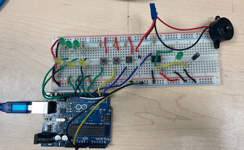

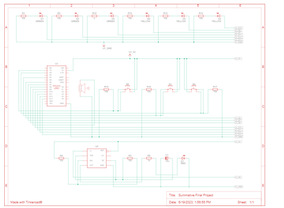

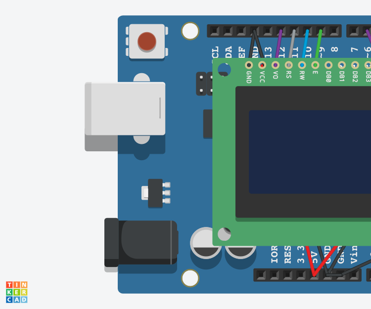

Now it's time for the wiring! All that's left is putting the components and wires in their spot. The diagram above shows you exactly where each wire and component should go. While wiring makes sure to look at every detail and try to make the wiring as neat as possible. If you encounter any errors or if something is not working make sure to see if the wire is in the correct spot. If you want to test the diagram for yourself you can see the TinkerCad in the code section. The components that have no code are the 555 Timer. A 555 timer adds a delay between the voltage getting to the red LED. This creates a blinking effect. Have fun with your game and show it to all your friends!
