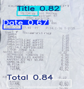

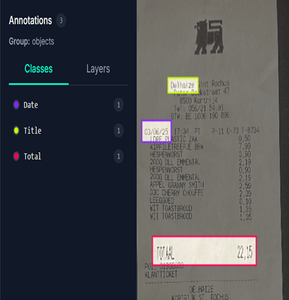

Step 1: 🔧 Train YOLOv8 Model
  1. Gather a dataset of 200–300 receipt images
  2. Annotate with bounding boxes: total, date, store
  3. Extract annotated dataset with augmented photos
  4. Train YOLOv8 using Ultralytics CLI or script
  5. Export the best weights (e.g. best.pt)

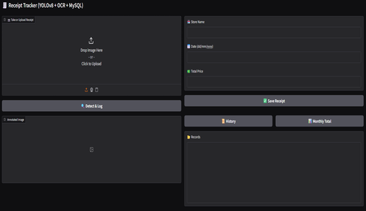

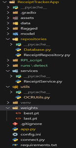

Step 2: 💻Develop App Logic
  1. app.py – Gradio UI for uploading receipts and displaying results
  2. ReceiptService.py – Runs YOLOv8 detection → OCR → extracts store, date, total
  3. OCRUtils.py – Cleans and parses raw OCR text
  4. ReceiptRepository.py – Handles DB operations (insert, fetch, summarize)
  5. Database.py – Sets up and manages MySQL connection

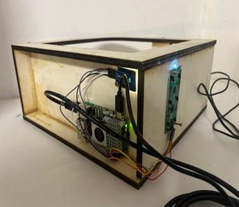

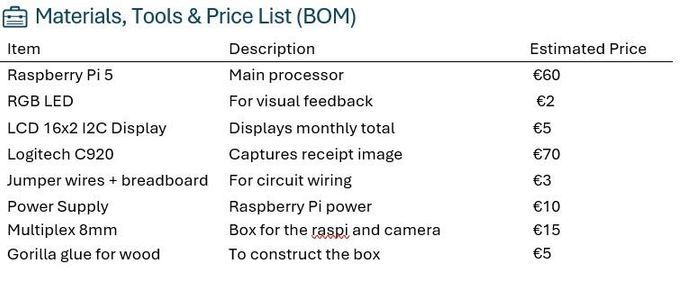

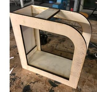

Step 3: 🪚 Laser Cutting & Assembly
  1. Created laser-cut file with:
  2. Walls, floor, and cutouts for the Raspberry Pi, LCD display, and RGB LED
  3. Assembled the enclosure by:
  4. Aligning cut pieces
  5. Gluing joints securely using wood glue.
Step 4: 🍓Raspberry Pi Setup

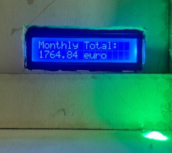

  1. Wire the LCD (16x2 I2C) – Displays the total monthly spending
  2. Connect the RGB LED – Provides real-time status feedback:
  3. 🟢 green = receipt saved
  4. 🔴 red = error
  5. 🟠 orange = idle/default
  6. Use lgpio and smbus libraries to control GPIO and I2C communication
  7. Create receipt_dashboard.py – Displays the current monthly total and sets LED color based on sys.argv input (e.g. green, red, etc.)
  8. Run dashboard_listener.py – A socket listener that waits for signals from the main app and triggers receipt_dashboard.py with the appropriate status command

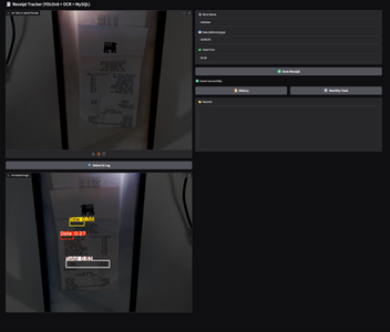

Step 6: 🧪Test & Results
  1. Upload or capture a receipt
  2. Verify YOLOv8 detects key elements
  3. OCR reads text
  4. Record gets logged in MySQL
  5. LED turns green + LCD displays total
