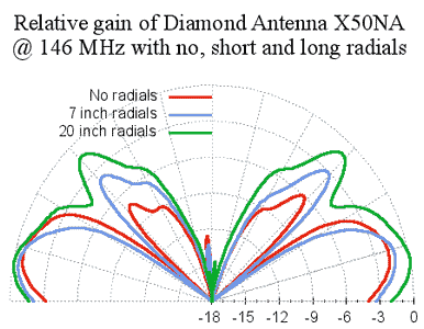

To be honest I got best results with my 2m/70cm Diamond X50 clone. This does have an issue that when the satellite is directly overhead the signal nulls out, but it is early days.

The noise bars are due to the satellite passing overhead, my (Diamond X50) antenna is vertical and reduces the signal overhead and the lower one is the signal being obstructed probably by my house or garage. I will be experimenting a lot more with aerials.
