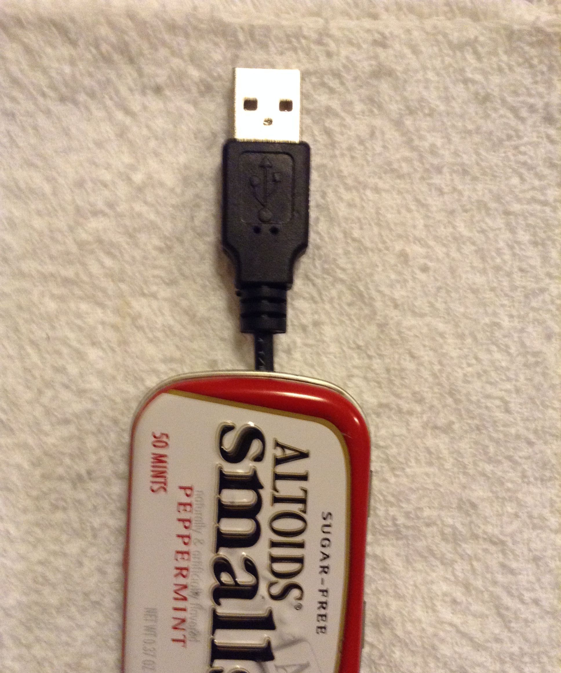

The next thing in the process of making this will be to assemble everything. The first thing that I did was wire in the button as depicted above. I pushed the button in and made minor sanding around the inside of the opening. The next thing was to pull the negative wire past the button and so on with the battery. I then soldered these wire to the LEDs that I had. On the opposite end I fetched the wires through the black plastic and soldered on the USB and its charging port. I also placed the cover of them both back on.
►I placed the battery just 1/4" above the switches hole, this will move.
Step 7: The Final Product
This could use some touching up such as the LEDs are not held in their respective place and you can see the sand marks in the translucent plastic. Other than that the concept turned out pretty well.
