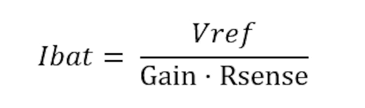

If the Vusb is connected, PIN3 detects it and powers ON the ACMP0H. The ACMP0H checks the Vbat voltage. DFF7’s output is HIGH, so no voltage divider is connected to PIN19. If Vbat is lower than 3 V the Pre-charging stage starts. PWM1 sets the current and CCMP1 controls it (IN+ Source with x8 gain of the CCMP1). In this case, the Up/Down input of the PWM1 macrocell is LOW, which means that we start charging from Vref = 160 mV for CCMP1 Vref (Figure 8). As a result, the CCMP1 maintains the 67 mA current:
As soon as the ACMP0H output is HIGH (the Vbat is higher than 3.0 V), the DFF7 output goes to LOW and the voltage divider is connected to PIN19. The Constant Current phase starts. In this case, the ACMP0H makes a comparison for 4.2 V (not 3.0 V as in 1st case). The Up/Down input of the PWM1 is HIGH, so the CCMP1 Vref is 960 mV. The resulting current is ~ 400 mA. Note that these current limits can be changed by changing the Vref value in the Reg File or by changing the resistor connected to the PIN 12 (Sense B).
