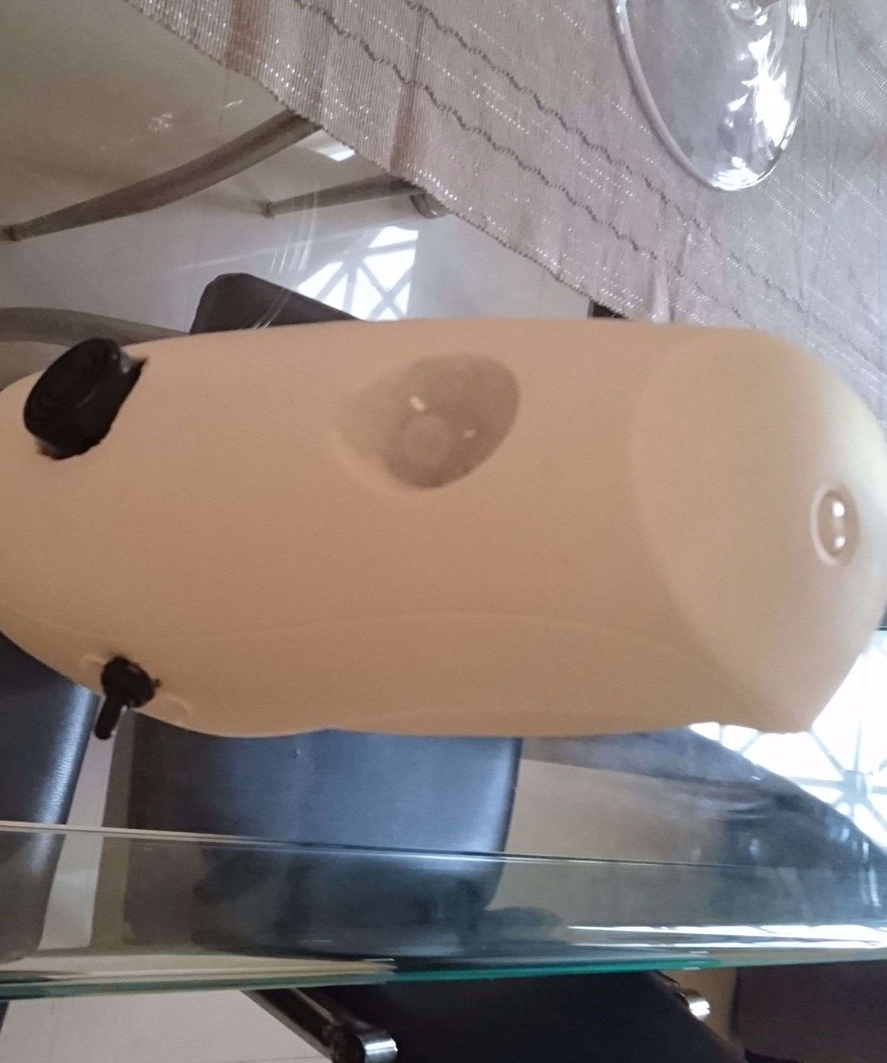

Step 2: The Layout
After deciding on how to lay the hardware, I drilled the holes.
All modules including the buzzer can work from voltage starting at 3V so the 3.7 V battery had to do because of its small size.
First I started by attaching the battery to the adhesive size of the breadboard, then used the double sided adhesive to fixate both to the plastic box and finally connected the positive and ground from the battery to the pin slots of the breadboard.
Next I soldered the wires to the battery charger module, fixated the module on the breadboard with the adhesive tape and connected them to the same row of the battery input wires accordingly.
I fixated the pir sensor with hot glue after positioning it in its hole. The buzzer hole required some mild enlargement which I did with the drill bit in order for the buzzer to tightly fit in. The toggle switch was also fixated with and outer nut that comes with the switch.
Finally I connected the wires as per the diagram on the photo.
There is no need for codes. The PIR sensor works without codes, just wait for it to initialize

Step 4: Final Result
an easy to make motion detection cat repellant. I dubbed it FOC (F..k Off Cats). I haven't tried it yet but the sound it makes is extremely annoying and cats to my knowledge are even more sensitive than humans when it comes to sounds. Hope it helps you! ))
